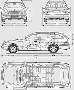

If you take out the seat bottoms you gain another six inches. I think 72x 30 would be no problem. In my 2006...

1857 / 25.4 = 73.11

the second row seats fold flat, but the seat bottoms hinge at the front and are vertical against the backs of the front seats. This is what allows the second row seat backs to form a perfectly flat surface. To gain an additional six inches of length the second row seat bottoms can easily be removed and your cargo can then go all the way to the backs of the front seats. This in my 2006 gives like 80 x 40 inches of space.
