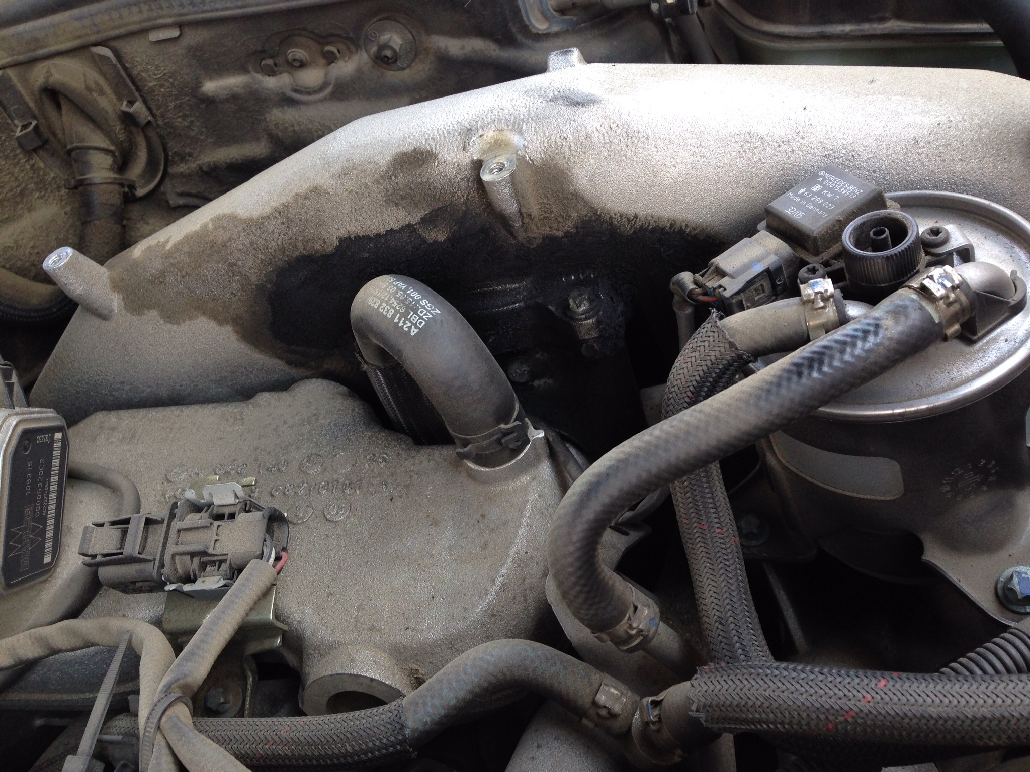

Hi all,
I've been leaking for a little while now - but it appears to be getting worse. Went to replace my glow plug the other day and noticed the buildup near the EGR (I think) getting thicker. The puddle on the garage floor also seems to be getting slightly larger every time I park. I can't seem to locate where it's all coming from.
Has anyone seen this type of oily leak pattern before? Any ideas? It's an '06 E320 CDI.
Thanks in advance!

It is PITA, I had same problem and the solution was making a channel for "151" O-ring on the surface of the mixing chamber, where EGR enters. Two years later - not a single drop.
