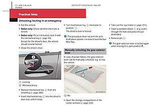

Your vehicle does not have SBC, to unlock from park see below, bleeding procedure: http://www.google.com/url?sa=t&rct=j...,d.b2w&cad=rja

thank you, but why are the gearbox in P,it will come out of P,when i use the emergency thing.but when i place it in p again, it get suck, i have no error codes??
I see on the scheme, do i also need to bleed the rear calipter for to make my front left calipter to work?
