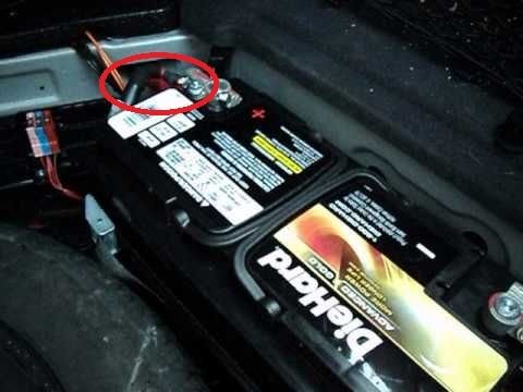

Well, I have tried to find where the leak appears. When my car is at sleep mode it shows value of ~130 - 140 mA, which is a lot more than 40mA as the best case.
By taking each fuse from all 3 places (hood, panel side, boot) nothing changes.
It does make a change when I take off additional cabel from positive terminal (*** in the picture), then the value becomes good.
At first it seemed that it is Battery control unit fault. I took it to the electronics fixer and he noticed that one of capacitors do not keep the load. Therefore he changed capacitor into the good one and now the control unit should be okay. But unfortunatelly it gave no change regarding battery draining. So it needs to find out what other modules, units are connected through this cabel.
Alternator works good. No drain appears concerning alternator - checked. Also when I yield a load to alternator it evens the charging voltage.
But then still there no answer about "BRAKE deffective" message which appeared because of battery disconnection for ~12 hours.
