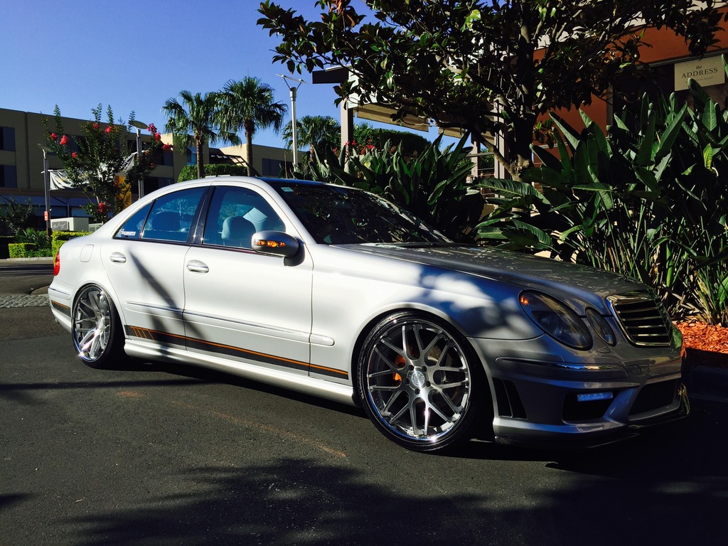

youre right, with coilovers, you can raise or lower your car to your liking. but imo, 35 at the front is meaty. i had 235/30/20 with 9" wheels front (a bit of stretch) and 275/25/20 10" rear when i had my 211 on coils and it scrapes a bit on the front when we slam it so we rolled the front guard a bit (not that theres a a lot to roll) but a couple of mm's will help a lot if youve got an aggressive stance. for me it just looks better.
