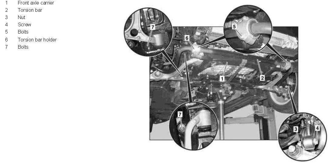

Here is my question i have searched all over the forums in regards to the passenger/right side stabilizer bracket. I purchased part 211323640, from my understanding this is the bracket that goes behind the stabilizer bar, I am in need of the front part of the bracket.
The dealer said i need to order the entire stabilizer bar, I found this part on ebay number is A2113231226 but do not know if this would fit.
I know several owners had come across the same problem, can you provide some information where i can get the part or have any ideas in regards to maybe an aftermarket kit.

I am not trying to challenge you, I had three dealers tell me the same thing the a bracket that mounts to the frame which is the part number i have provided, then the stabilizer bar with the bushing and the closing bracket
I need the bracket that mount on the front of this, the bracket comes with the stabilizer bar

You can see from the picture it is a 2 piece bracket.

I always thought one bracket was molded to the sway bar and the other bolted to the subframe????
