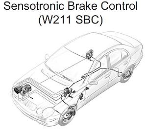

Thanks guys really appreciate it. What would be a wind up noise the . I was thinking it might a compressor. In the front sounds like pass side hood??? Any ideas?

SBC hydraulic pump, normal.

When you hear SBC pump this is not the best sign.
I have to be in very quiet garage to hear the noise on my car and per my record the pump is 7 years old.
Would be good idea to have SBC count read on SD

The whole point of depress count is to replace the pump before it wear out.
Suppose it is fixed number, but different software and different experience are not solid on it.
Than you can buy scanner on ebay that will reset the count without doing the service.. think about it.

Good indy should be able to replace the pump and enter it into car computer, but average indy don't even want to touch those brakes, meaning lot of owners have stealers as only option.
Prices drop down from the time when new pump would be quoted in $3k range.
Honest people should not hear about illegal reset, so that is good sign.
