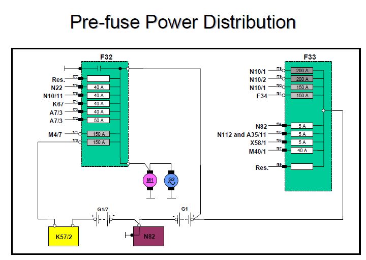

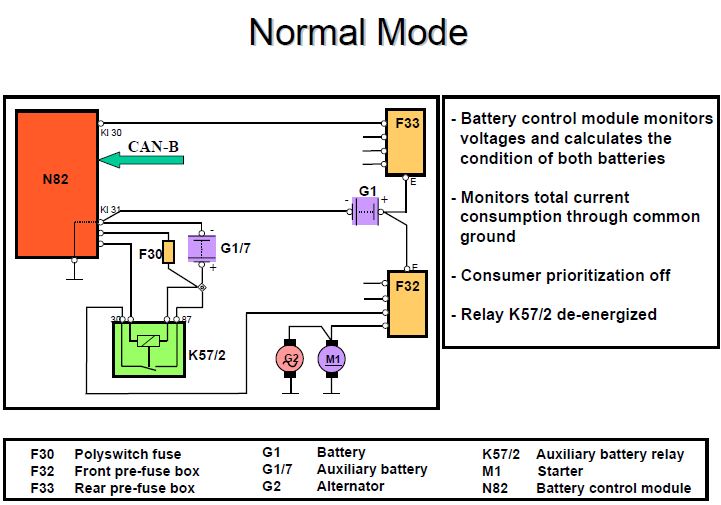

Easier to post schematics and info. Excerpt from the training file. G1 is main battery. G1/7 is auxiliary battery.
Attached Thumbnails Please help this scared me today !-aux-bat-1.jpg   Please help this scared me today !-aux-bat-2.jpg   Please help this scared me today !-aux-bat-3.jpg   Please help this scared me today !-aux-bat-4.jpg
Thanks for posting.
The schematics show the program idea, but I guess there is much more behind it.
Per emergency mode, when main battery goes low, the computer switches off some customers, but supply the rest of electrical system from aux battery.
That means that in some situation the aux battery can be drained by lights, leaving no power to SBC ?
Tell me it isn't so?

Originally Posted by kajtek1
Thanks for posting.

this thread is goin way out of context coz OP wont get the proper solution which is go to an indy to have it checked. sadly, this problem is not a simple DIY where you simply replace a fuse or reset something with your key.
I had the same problem before from time to time and wasnt really bothered until the main battery gave (cant unlock the car much more start it) and i had to replace it. this warning has nothing to do with the SBC since that function runs mainly from the aux battery. the warning shows and shuts off non crucial elements/function on the car, lights, stereo, nav system and others, it will prioritize starting the car and being able to drive it safely.
now, OP said he has a a 6 month old main battery. this warning showed up, maybe its a defective battery like i said before or a busted alternator. but until OP gets it checked, we can all just speculate on whats wrong with it. have it checked or leave it as it is.
