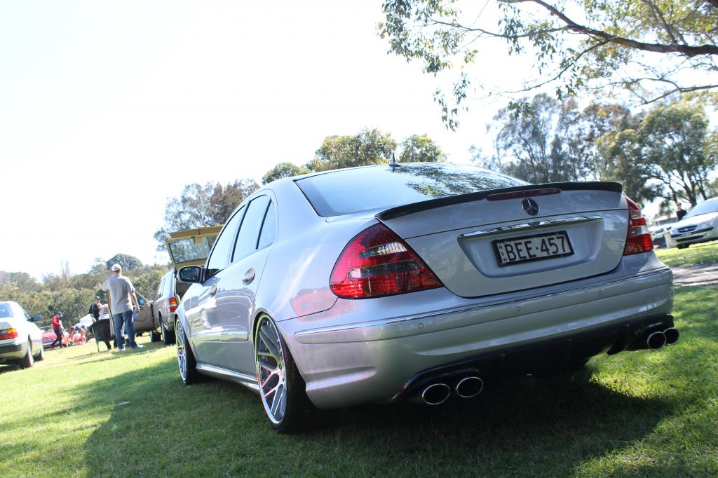

EDIT: Although i replaced my rear bumper bar with an AMG bumper on my old 211, heres a photo of the diffuser im talking about.

Wow, beejamg, your 211 looks absolutely amazing! Mine is in the same color, plan on getting black trunk lip as well. How much does a C/F diffuser cost?

cheers mate, yeah shes was a looker. sometimes i wonder why i let her go. oh well...
the diffuser was really easy and fitted alright (not perfect as its an aftermarket) as it was for an amg bumper but im not sure if it will be a perfect fit for non amg bumpers but you can always try as we just put anti-rust self tapping screw from the inside of the bumper. easier if you the car is on a lifter. just make sure the screw is long enough but not too long to not pierce through the diffuser.
iirc it was around US$300 from ebay. well worth it mate. looks very aggressive.
