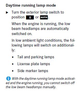

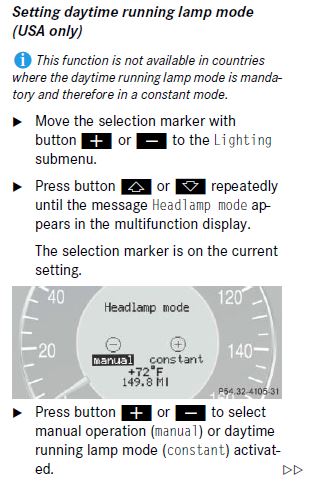

I don't know how but my headlights are always on as soon as I start my car. The switch with not shut them off. I can get the front and rear fog light off and on but that is it. What happened? I have no errors.

DRL?
Attached Thumbnails Lights on my 2007 e350 issue-capture.jpg   Lights on my 2007 e350 issue-capture2.jpg
