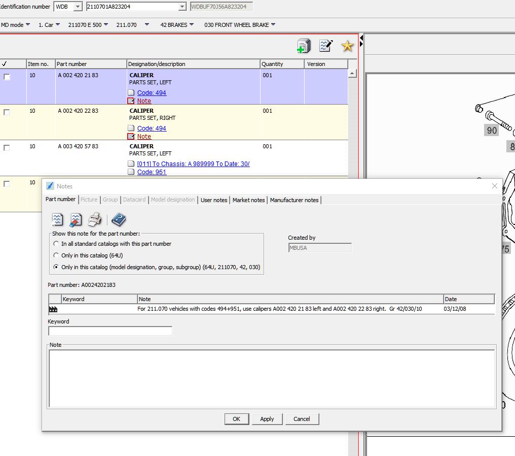

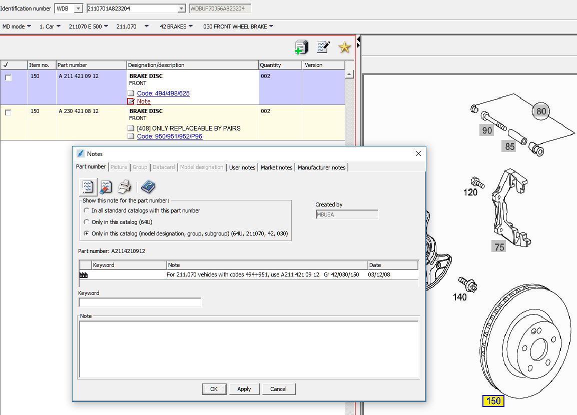

Front
- disc 2114210912
- pads 0064203220
- right sensor 2115401717
- left caliper 0024202183, right 0024202283
Rear
- disc check vehicle: solid 2114230712, or ventilated 2114230912
- pads 0074201020
- left caliper/solid disc 0024202583, right 0024202683
- left caliper/ventilated 0024202783, 0024202883
As mentioned your vehicle is equipped with Sport package (see attached data card, 951): dual exhaust pipes, staggered AMG branded wheels, sport suspension, white gauge instrument cluster, sport front apron/rear bumper/sculpted side skirts, and leather interior with black Birdseye maple wood trim. AMG trunk badge was added by previous owner. If you google caliper 0024202183 and view images available you will see Mercedes etch is not unique to AMG.

Seems to be early build equipped with 2005 AMG Sport Package rather than 2006 Sports Package “may” be the reason for black instrument cluster, and walnut wood trim. Elegance = luxury/comfort model (Avantgarde = sport).

So would the same brakes listed above apply if my car was equipped with an early AMG Sport Package?
Yes, check notes on MB part catalog captions posted above 494 (USA) + 951 (sports package) as confirmed by data card. AMG package = appearance enhancements.
