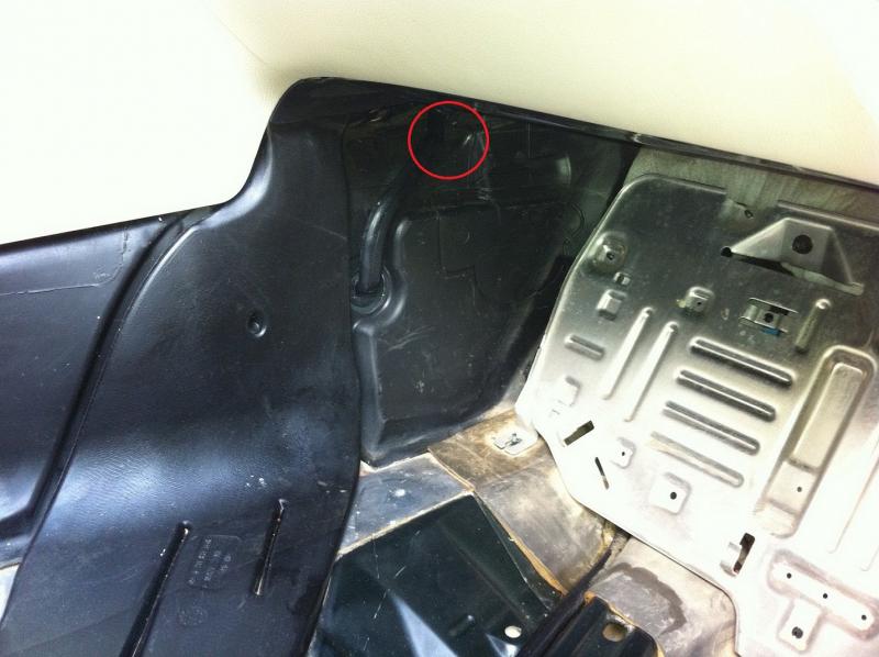

Old Aug 20, 2016 | 04:46 PM
konigstiger's Avatar
Posts: 15,901
Likes: 4,632
From: North Scottsdale, AZ
'71 Pinto
Drain inspection.
Attached Thumbnails Water Building Up Around A/C Vents-drain.jpg
