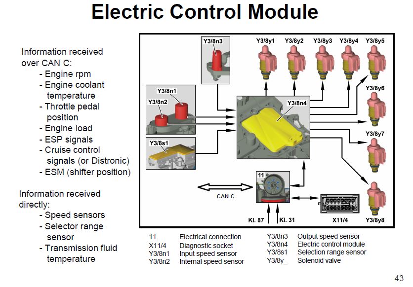

“Suggestions”, check f46 @ front SAM (for the hell of it) and consider, control module selection range sensor (y3/8s1) may have been damaged or needs to be relearned-in using MB DAS.
Attached Thumbnails Won't Go In Gear after Changing Trans Front Pump-capture.jpg   Won't Go In Gear after Changing Trans Front Pump-capture2.jpg

Yesterday I dropped the pan and discovered I had correctly installed the metal parking pawl (rooster tail) into the valve body spring, but the plastic range selector sensor was not hooked onto the parking pawl. The part number was y3/8s1 as suggested by konigstiger and cmriv. It was immediately apparent that this was the issue, it should have been a super easy fix.........
See this YouTube video (7 minutes, 35 seconds in) for proper installation of parking pawl and sensor (although his hand does obscure it, the range selector sensor appears yellow/orange in lower left hand corner of screen):
To remedy this, I loosened the valve body bolts enough to slide the plastic sensor into position, but in doing so, the plastic broke as the spring was still exerting force onto the valve body and the plastic rod was kinked and seized inside the sensor bore. I didn't remove the valve body because I was being lazy as it isn't as comfortable to install it on a lift overhead as it is on the benchtop.
After cracking the rod's hook, I tried to epoxy it and used some copper wire drilled and tied into the plastic, but that repair didn't work after I installed it again in the vehicle. The epoxy repair failed and the copper wire was holding it all together, albeit out of adjustment enough for the sensor to be reading Reverse when the Shifter was in Neutral.
I ended up sourcing a used replacement "rod" through a transmission shop and will have it shortly. Apparently, it is a common issue - the plastic rods become brittle with age and if you aren't careful when reinstalling the valve body, you can crack it. I didn't even realize the sensor was there as my transmission experience is with rebuilding older domestic transmissions.
