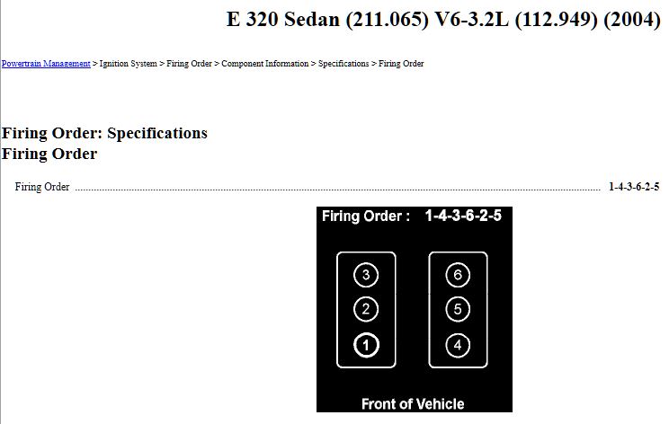

I'm looking for a picture of the ignition coil order for my 2004 E320, 5 being the most important at the moment and have not been able to locate one. Can someone please assist?

Remove/install: http://workshop-manuals.com/mercedes...ce_and_repair/

Thanks for the reply konigstiger. I'm trying to locate ignition coil 5 on my 6cyl E320, I can't tell on the picture which one that would be.

Looking from front of vehicle, right side center.
