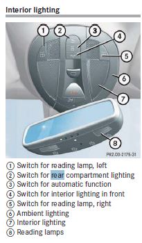

Rear dome is fed from front dome unit (overhead control panel) check switch for rear dome (2 in image).

Thanks, I'll check it out! Does this switch have any effect on the ambient light for that pod? Ambient is set up at night but is not functioning back there either.
