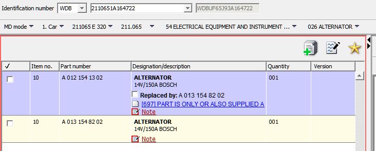

Old Nov 27, 2016 | 01:32 PM
konigstiger's Avatar
Posts: 15,901
Likes: 4,632
From: North Scottsdale, AZ
'71 Pinto
OEM part is 0131548202 14V/150A.

Old Nov 27, 2016 | 01:43 PM
speedracer.eric's Avatar
Joined: Oct 2015
Posts: 49
From: Texas
2003 E320
Thank you for looking that up!
So do y'all think the 12v that I bought at O'Reilly will bolt on but doesn't put out 14v so will cause me issues?

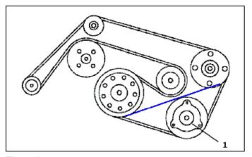

Posts: 15,901
Likes: 4,632
'71 Pinto
New batteries and alternator, next components to check belt & pulleys if fine consider replacing alternator to OEM – definitive diagnose have someone with MB DAS (diagnostic system) check for fault codes.
