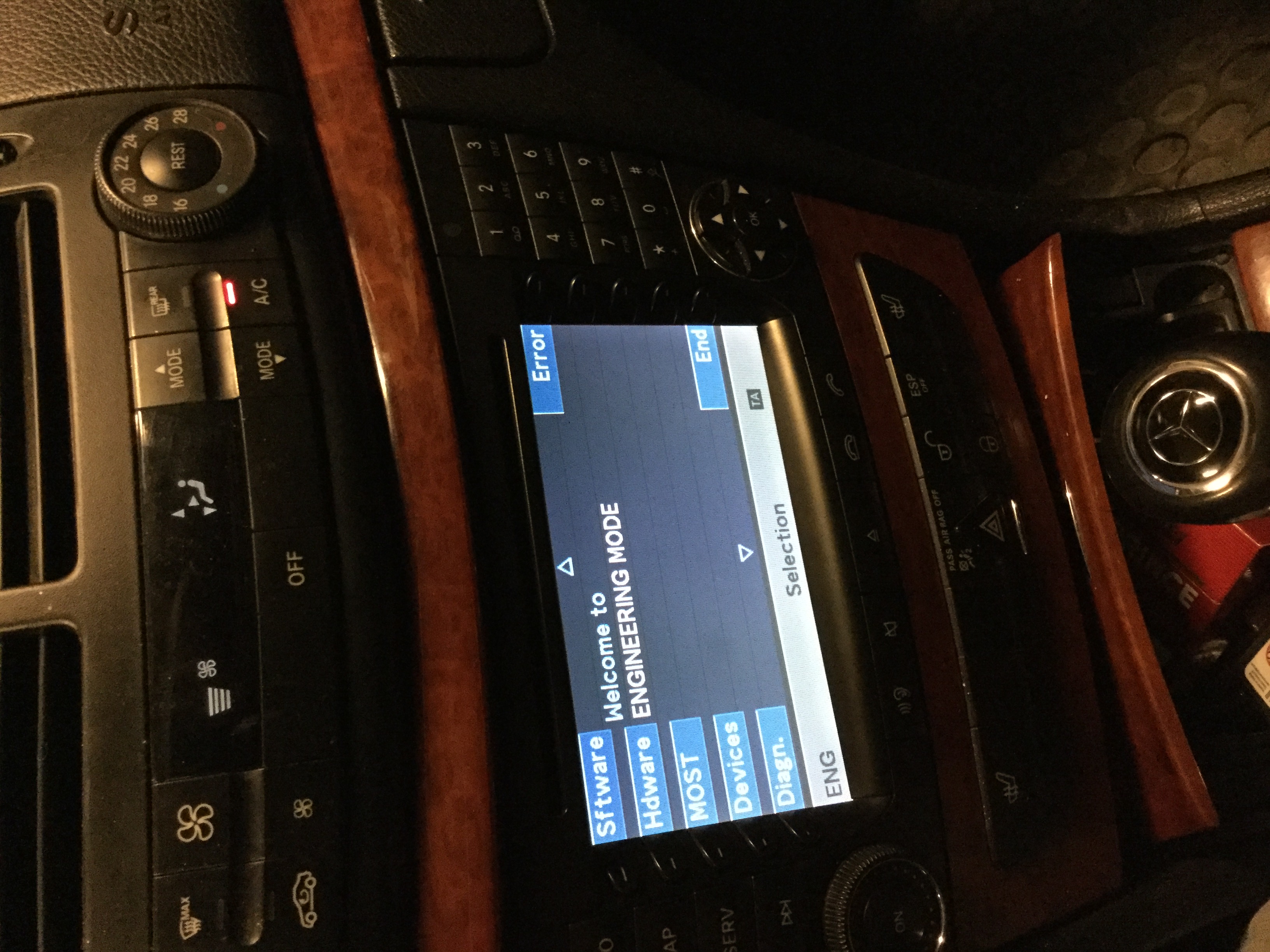

I have a ntg1, and i would like to get the vim"video in motion" to work, but i can find the codes,button sequense!
Do i need to down grade the software?
I can enter the engineer mode
I attached the pictures of the software version&more

Pretty sure you can't enable VIM via engineering mode... but I could be wrong. Best bet is to find someone with DAS/SDS and code it. Should take all of 5 minutes to do.
In Mercedes Star diagnostic MB SD Connect C4 DAS Developer mode :
Audio, Video, Navigation und Telematik ->F3
a screen might pop up with all kind of settings, ignore and press F2
New screen with ESD warning ->F3 COMAND /AUDIO -AUDIO 50 oder COMAND ->F3
Entwicklungsdaten ->F3
Steuergerate-Anpassungen ->F3 Steuergerate-Anpassungen (Variantencoderierung) ->F3
HU Parameter ->F3 scroll down to line: Driving speed is more than 0 kph and
Driving speed is more than 10 kph and BOTH enable them and ->F3 to confirm coding
Now you be able to watch DVD/TV when car is in motion
