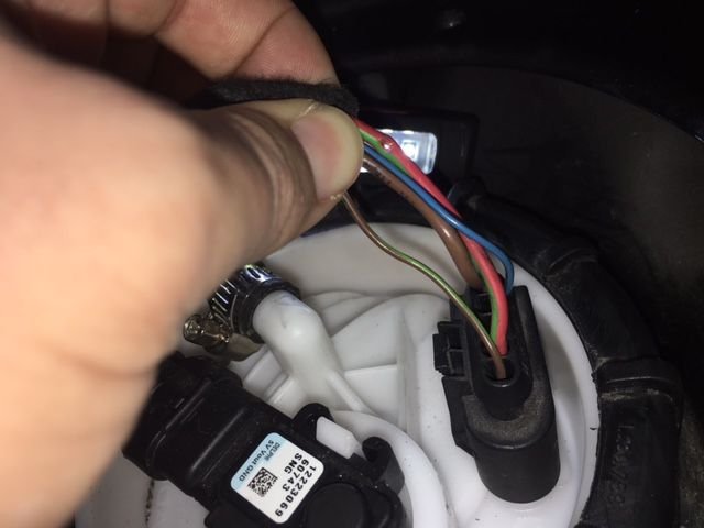

2007 E350 (W211)
I can say im a decent mechanic however electrical is not my strong suit...but something is telling me this may be my problem. I have a hole clean through my power wire to pump and some degradation in the insulation on the ground wire and power wire at the connector. Im guessing this problem comes up when the car is "hot" because the wires are also hot from running for awhile and this causes arcing? electrical gurus I ask for guidance. Also should I re-wire or use liquid electrical tape to cover degradation parts

Looks like it to me Scott .Can you remove the plug, and cut off the bad part of the wires and then re fit the leads back in the plug . With the damage on the wires can the short be inside thats doing this .

It looks like someone used a test light at one time to check on voltage. It does not look like any of the wires were pierced completely through. Just some liquid electric tape should ease your concerns.

the hole actually goes all the way through on the power wire. the first picture is of a light i have shining through the hole. I spent some time while at work today looking for a new connector but I didnt find any so I guess ill deal with it the old fashion way. I haven not owned the car for very long but boy has it been a head ache getting straight.

Scot is that the rear of the fuel pump in the picture with wires showing? Can you wire a bulb up to the power supplyfor the pump .And put the bulb in the car so you can see it .I did this once on a Saab i had , it keept cutting out .By doing this i knew it was the pump or the fuel relay after bulb went out . If light stops on and it stops ,your pumps faulty Did you check the fuses ? may be 2 fuseboxes on your model.And a fuse you missed out.
