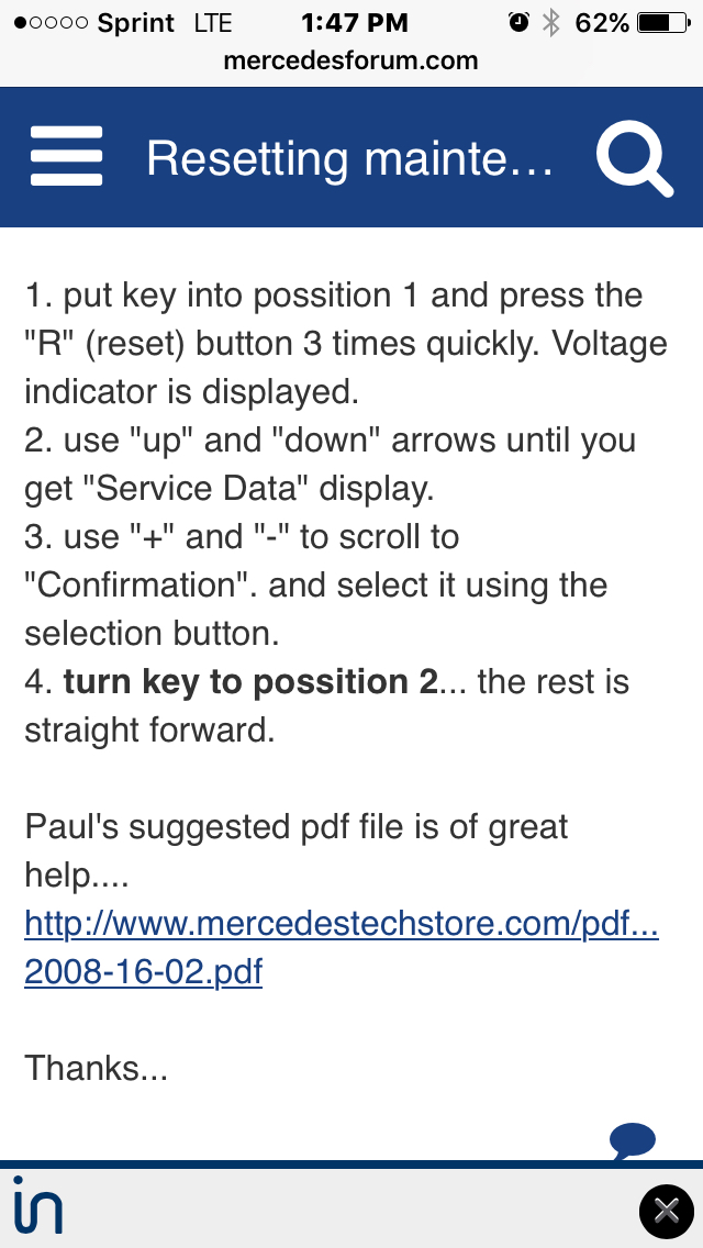

Anyone know how to reset the indicator...Presently pops up at engine start up and indicates I'm almost 800 days behind schedule. Display message disappears when I shift out of 'park' into another gear.
Thank You.

Try this and see how it works. "Reset button" is the one on the instrument cluster.
Good luck,
IG

Thanks so much...it works great.
