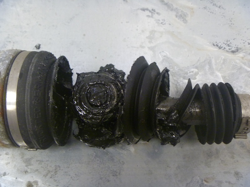

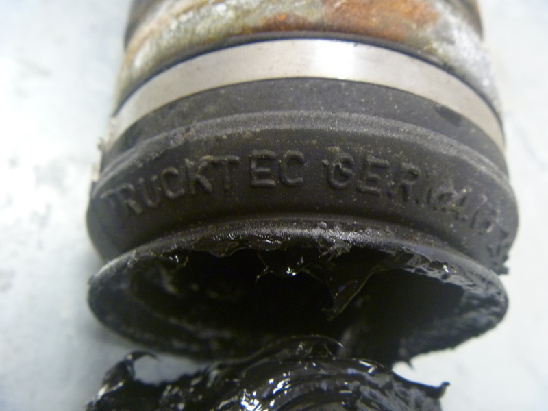

I just had a bad experience with a "Trucktec Germany" brand inner CV boot kit that I installed on my 2009 E350 4Matic wagon.
Take a look. This is what it looks like after 3,000 miles.
I suspect this is due to the rubber being incompatible with the grease they supply in the kit. I have never seen disintegration like this before, except on boots with over 30 or 40,000 miles on them, and even then it's usually a single crack. I have installed many CV boots over the years and the install process of this was as perfect as the best I've ever done. No stretching while installing or anything.
I have replaced this with the genuine Mercedes boot kit. Both the older (flawed?) one, and the genuine one were purchased from PelicanParts.com.
I notice that the genuine boot's material is both thicker and stiffer than the Trucktec boot. Also, the genuine grease for the inner CV joint is amber, while the Trucktec-supplied grease was black (moly content, likely).
So, long story short, I would recommend people buy the genuine Mercedes CV boot kits, when needed. This is one instance where it's just not worth the savings to buy aftermarket.

Should'a read my pictorial topic before spending money on aftermarket.
I bought aftermarket boot from autohousaz, what is reputable supplier, but they don't test the stuff they sell, so they lost the part, I lost my time trying.
Present yourself as business owner (you do something by yourself, don't you) and dealer will give you at least 10% discount without investigating.
So with some trick dealer part will come just few dollars more, but will avoid your wasted time.
That said, I did have good luck with aftermarket German boots on W210

I do remember reading your pictorial, but a few months AFTER having done this the first time, with the bad parts :/
Thanks for the discount suggestion.
