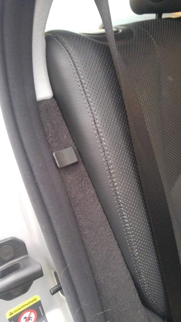

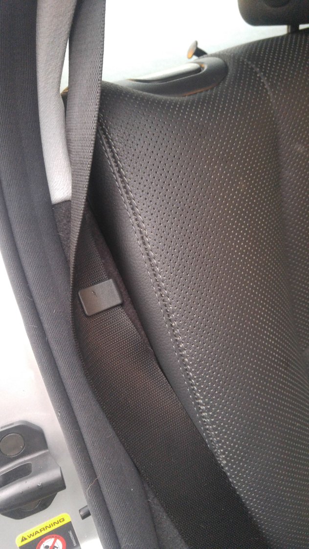

Gave a friend a ride the other day. She made a remark about, "how no one has ridden i the back seat and the belt was stiff."
How can a 13yo car not have ever had a passenger? It flashed before my eyes but before i could utter a word ....snap. She yanked the belt from its tie back and snapped the small plastic hook.
Ive tried searching for this part but apparently i am not clever enough to come up with the combo of words that would lead to me finding it.
This is the opposite intact part doing its job
Anyone know what to call this or its part number. I dont want to tear apart the trim until i have a replacement.

EPC shows incorporated into bottom c-pillar panel not available separately, need VIN to supply panel part # inclusive of color code. In the mean time e500 wagon you can search left 2116904753, right 2116904853.
