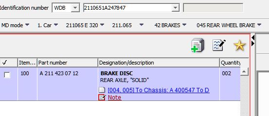

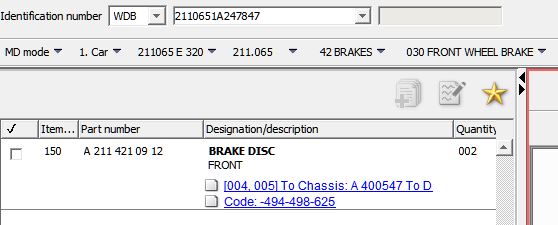

Can anyone please tell me which rotor part number is the one for my car? on the epc I have there are 4 part numbers.
WDB2110651A247847
i had previous issues with ordering pads also since my car is not from usa.
http://mb-teilekatalog.info/view_Sub...=42&subgrp=030
number 150
WDB2110651A247847

Front disc 2114210912, rear 2114230712 see attachments.
