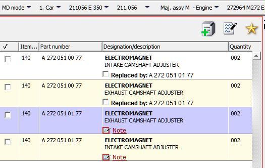

0272 - Continuous camshaft adjustment (right) incorrect position of intake camshaft
Best case scenario solenoid needs replacement, see right cylinder attachment y49/5. If part # 2720510077 is installed I suggest replacing all 4 to current part # 2720510177. Worst case scenario if engine # is below 30 468993 possible balance shaft problem see attached bulletin and instructions.
