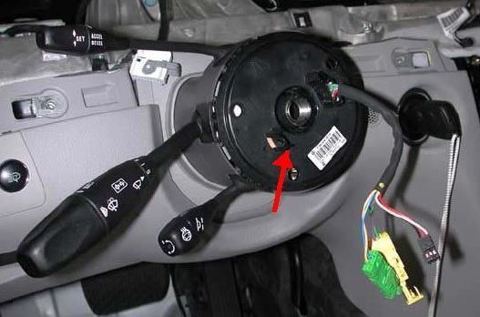

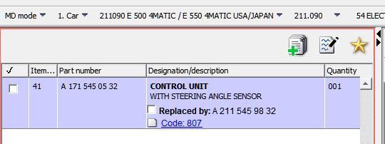

Could steering angle sensor. Have someone pull codes using MB DAS, plenty of purchase recommendations on the forum. Current part # 2115459832 start shopping here: http://www.usedautopartsyouneed.com/...9832-2057.html

There's also this youtube video that I followed:
Also about $189 new.
https://www.oediscountparts.com/part...&siteid=215242
When I replaced mine, the center piece seemed pretty loose, the new one didn't have any play in it. Only real hard part was getting the nut off the center of the steering wheel so I suppose if you get a used one, it's about an hour or so to replace it again.
