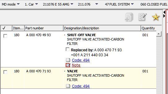

P2075 P0456 Purge control system has a slight leak (minor leak): Leak in shutoff valve of activated charcoal canister. Canister should be located behind right rear wheel.
