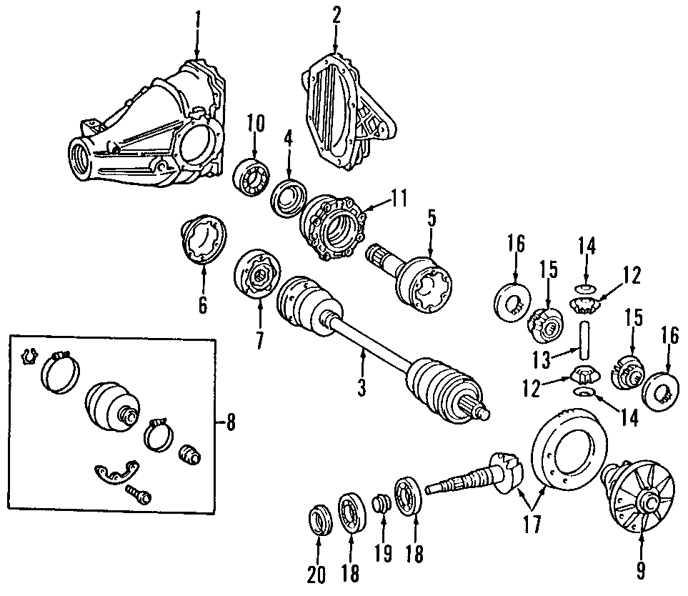

Here is the diagram, what parts do you all suggest I check?
REAR AXLE. DIFFERENTIAL. DRIVE AXLES.
PROPELLER SHAFT. AXLE SHAFTS & JOINTS.
