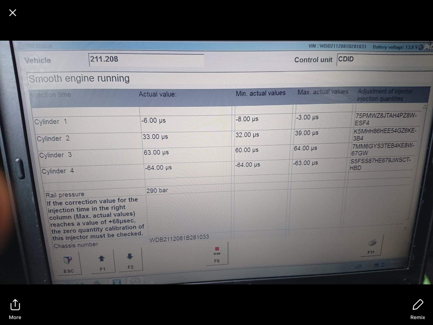

Hi, my w211 220cdi suddenly stalls, when i put it in drive, this happens only when its warm, and have been off for like 5mins. when it stalls, it sounds like its one three cylinders, and then it comes back on four, and it repeats, if i then put it in drive, it stalls, and die!
Could it be one of the injectors that is starting to get bad?, please see image from star c4
