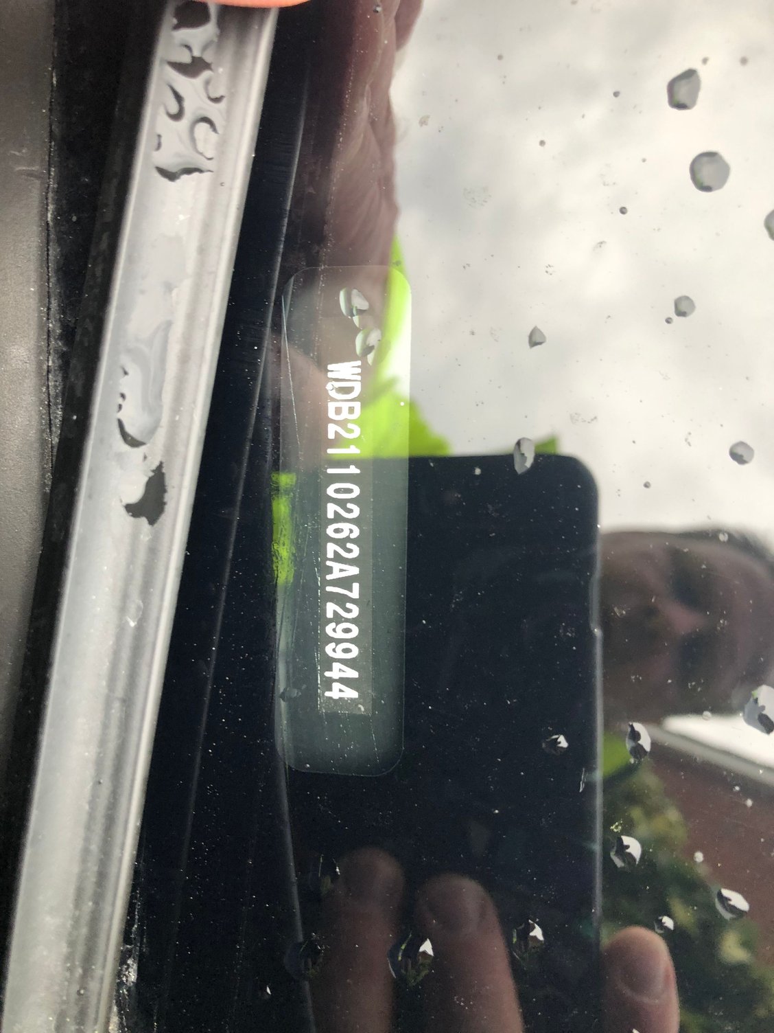

VIN? I will check WIS to confirm part #. See attachments.
Here you go Thanks for your help !

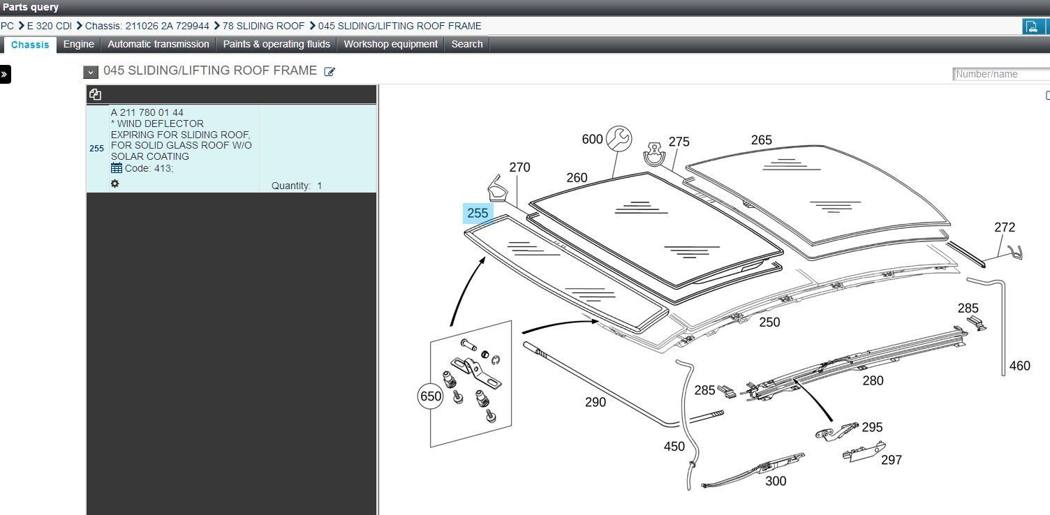

Hi
min that last attachment it’s part 5 I need to change . The front glass wind deflector
thanks
File Type: pdf
File Type: pdf
Old Jun 11, 2019 | 01:25 PM
Digritz's Avatar
Joined: Oct 2014
Posts: 10
Cl600
Perfect !!!

Old Jul 20, 2023 | 06:01 PM
gsohal's Avatar
Joined: Jul 2023
e240 2003
Part no 300
hello, I know this thread is old. I'm after part no. 300 in this diagram. I think it's called a linkage rod. Mine has something missing. When I open it a metal bar pops up, so I have to hold this down when closing. Thanks in advance.
