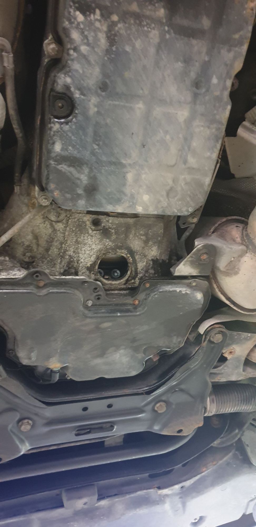

Should this be covered and if so is there any link where can i order this cover

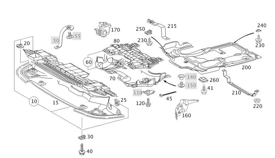

Center hole allows access to drain torque converter. There should be 3 soundproofing panels: front (10 in diagram) part # 2115203623, center (60) 2115204323, and rear 2115202623 (200) see attachment.
