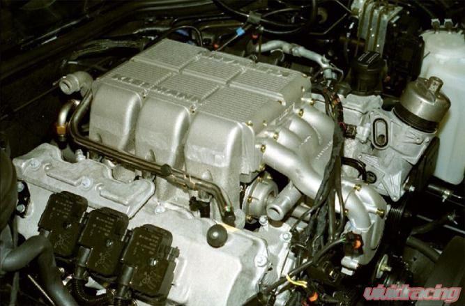

Not the same engine. c32 was an M112. Your 07 is an m272. Kleemann made aftermarket supercharger kits for the m112 and I've seen a couple in E classes but nothing for the m272. It's too fragile and pointless.
https://www.drive2.ru/l/1781420/
