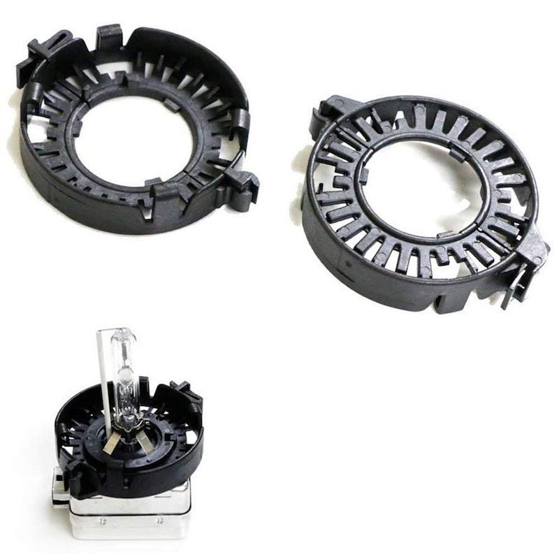

The driver's side HID bulb should be equipped with the black round plastic retainer ring (see picture below)? You mentioned a square ring but I'm not sure if you and I are talking about the same part. It's possible that the PO changed bulbs and replaced that retainer with the wrong style.

You are right Robert. Today I took out both lights. The one on the left side in the photo was on the driver's side. The retainer is missing. I was wrong about it being square. It doesn't have the retainer, period.
So the obvious next question is "What is the part number for that retainer?"

These rings are available from a bewildering variety of places, not just MB dealerships. Buy it off Amazon or Ebay; search for "D1S retaining ring". Or go to a local wrecking yard that offers U-Pick services and take it from any vehicle that uses D1S HID bulbs (Audi BMW Mercedes Buick Cadillac Lincoln Jaguar, to name a few). There must be local independant shops that sell replacement D1S bulbs and LED customization kits who would also stock these retainers. Or maybe even an aftermarket auto parts shop like NAPA or Pep Boys will have them.
I highly recommend that you get the retainer ASAP. I had a mechanic change my HIDs and he made the same mistake. My HID bulb shorted somehow inside the reflector and took out both the bulb and the ballast. It was a costly mistake (as I had to replace two HID bulbs and one ballast).
