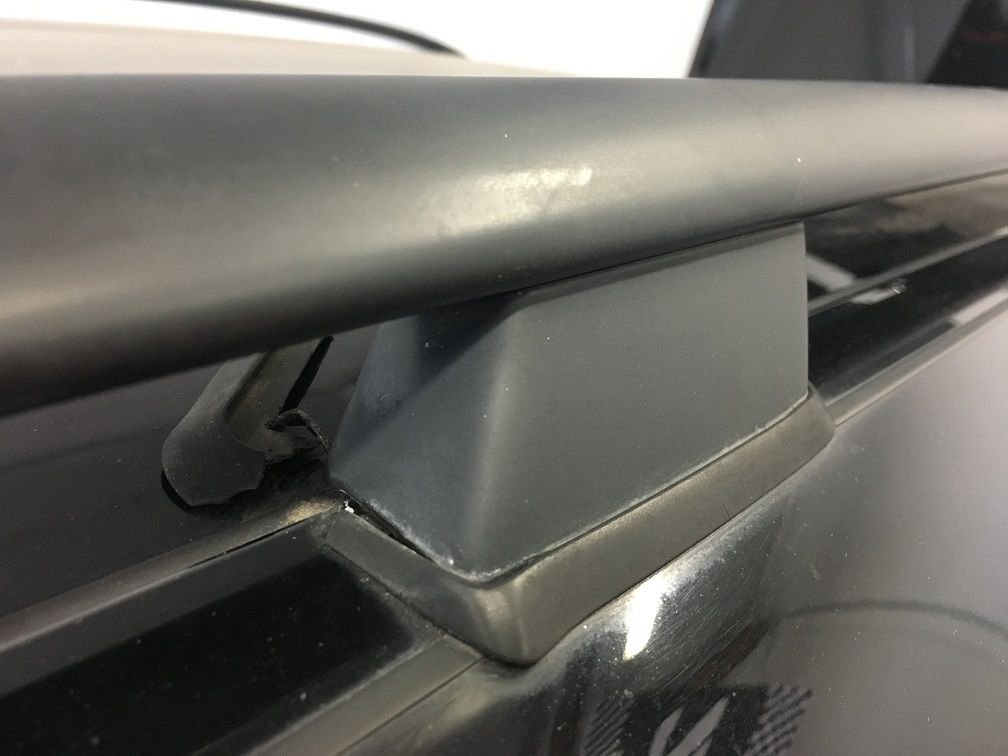

Can anyone help me locate replacement rubber gaskets for the side rails on my wagon? Mine are brittle and beginning to fall apart. I'm removing the rails in preparation for wrapping the roof, so this is the time to replace them. It seems I may have to try and piece the old ones back together. Thanks for any help.

EPC shows pads were discontinued, MB currently offers only complete rail assembly left 2118400924, right 2118401024. Although online vendors show following as not compatible, check with dealer they are available and “may” fit:
Left front 2118490176, center 2118490376, rear 2118490576
Right 2118490276, 2118490476, 2118490676
