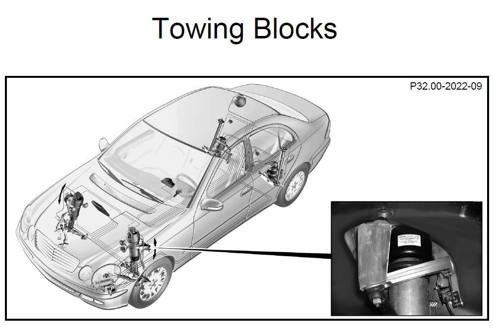

Jack the front of the car up (see Youtube for assistance) and insert towing blocks. You can use the rubber Mercedes blocks ($$$) or just put a piece of wood in the same location. If you use wood, load the car onto a flat bed, do NOT tow the car as the wooden blocks can bend the upper control arms. The rubber blocks are springy and will not damage the upper control arms.

Plz give me more information about the towing block, i didn't found any info, plz give me more information.
Where to put the wooden blocks exactly !?

Plz i need the dimensions of the block, i didn't found it and i have to make it of wood myself, i need the height of that block !!??

A sqaure piece of 2x4 is sufficient. This is not rocket science. You just need to raise the front suspension 2 to 4 inches so the tires clear the fenders.
