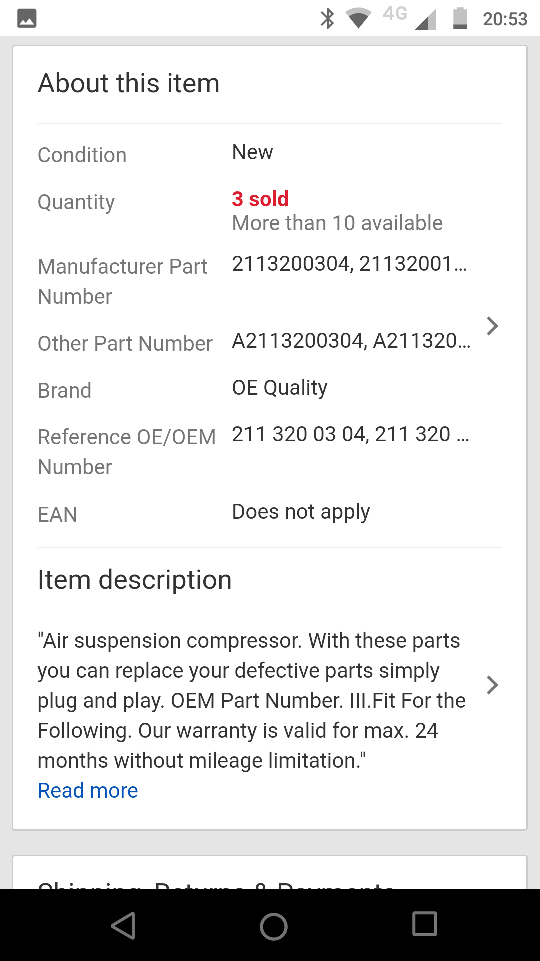

Continued follow every cm of the lines no leak anywhere took apart half car it felt like. No leaks at all. Then I got the idea to loose the hose from compressor to the valveblock and taadaa the valveblock created bubbles immediately! See attached pic. Now I wondering is this my problem? Faulty valveblock? I searched some and find this on eBay but it felt very cheap for being both valveblock and compressor? Is it some replication or do you guys think it's reliable?
https://www.ebay.com/itm/Air-Suspension-Compressor-A2113200104-Valve-Block-For-Mercedes-W211-S211-W219/174010311969?epid=5034025897&hash=item2883d2a521:g 94AAOSw0dpdZMoQ
If so I think it's better to replace the whole package instead of just the block?
*Edit hmm eBay blocked so I took screenshots instead.
