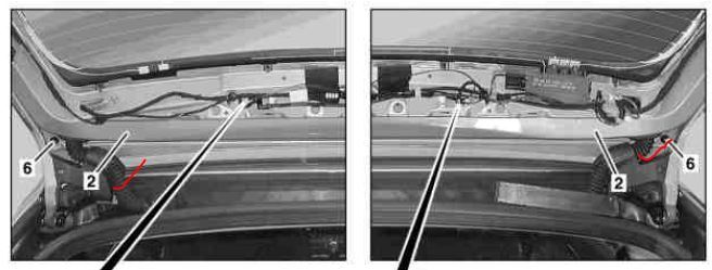

Assume you checked wiring @ l/r harness:
File Type: pdf
File Type: pdf
File Type: pdf
File Type: pdf
File Type: pdf
