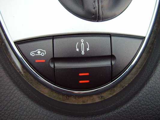

Depending on how it's optioned it either has coils up front and self leveling airbags in rear OR airbags all around (aka airmatic). The quick way to tell the difference is look for some buttons just behind the shifter for level control. That's airmatic. Rear airmatic airbags and shocks are far more expensive than self leveling equivalent. Both systems use an air compressor and level sensors to adjust ride height. With self leveling you can load up the car with 7 passengers and the ride height remains the same. It's awesome.

I have a 2006 E350 4 Matic wagon that I bought 2 years ago.
I don't know if I have airmatic in this version...is there a way to tell?
Old Jan 15, 2020 | 02:17 PM
tjts1's Avatar
Joined: May 2017
Posts: 2,290
Likes: 435
C320
Do you have buttons behind the shifter to move the car up and down? If yes then you have airmatic. If not then it's just rear self leveling.
