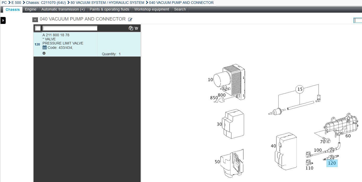

I narrowed it down to this
9254 - pressure relief valve for draining opens without active overpressure run
But when I search all that pops up is for the airmatic suspension. This is the pump in the trunk for the dynamic seats. Checked for leaks, couldn't see or hear anything and it does hold pressure and I can actuate it now, but it goes up to 21 psi max and it will hold there and it should be able to go up to 38 but it doesn't. No sound of a leak or anything in the seats or trunk area. Can't release any Pressure via my scanner either.

Pump in trunk is for dynamic seats. Suspension pump is located up front below driver's side headlight. I once had something similar to yours, car got sold a couple of years ago, so I accessed pump in trunk on driver's side and it was a loose air hose going into pump. So I re-attached it well and put a plastic tie around it. Hopefully, Kajtek1 sees this and adds his 2 cents, he's very knowledgeable about this and even came up with a way to rebuild that pump.

I narrowed it down to this 9254 - pressure relief valve for draining opens without active over pressure run
Revisit air lines (both pump & reservoir) reattach all lines/connections making sure they are tight. Valve is part # 2118001878 but good luck trying to find it.
