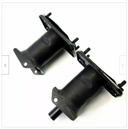

Looking for the two black brackets that hold the reinforcement bar in the rear bumper on my wagon. I know the bar itself is different from the sedan but the tubular brackets look exactly the same. My passenger side is heavily rusted and I would like to find these to replace. The dealer sells the whole assembly as one part so I'm not sure if the parts are interchangeable between the wagon and sedan. I did find some on ebay but I'm not sure. Thanks!

The bumper bar and the bumper mounts (pictured) are identical between sedan and wagon. I replaced my wagon bumper mounts with parts from a JY sedan because the previous owner welded on some steel plate for a ****ty Jerry rigged trailer hitch. Also the sedan Curt 117013 trailer hitch which attached to the bumper mounts fits the wagon perfectly.

Thanks so much!
