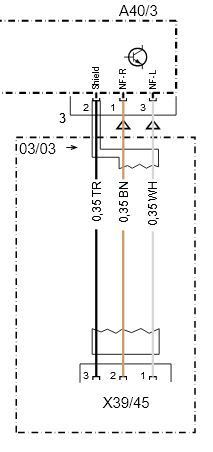

No difference adjusting via COMAND manual:

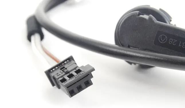

Worst case scenario harness may need replacement (part # 2115409910), pull COMAND unit (plenty of videos) and check connection @ rear.
