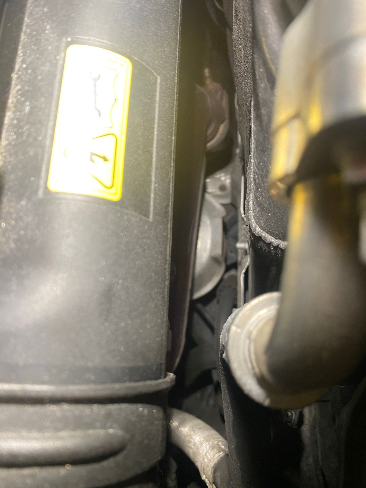

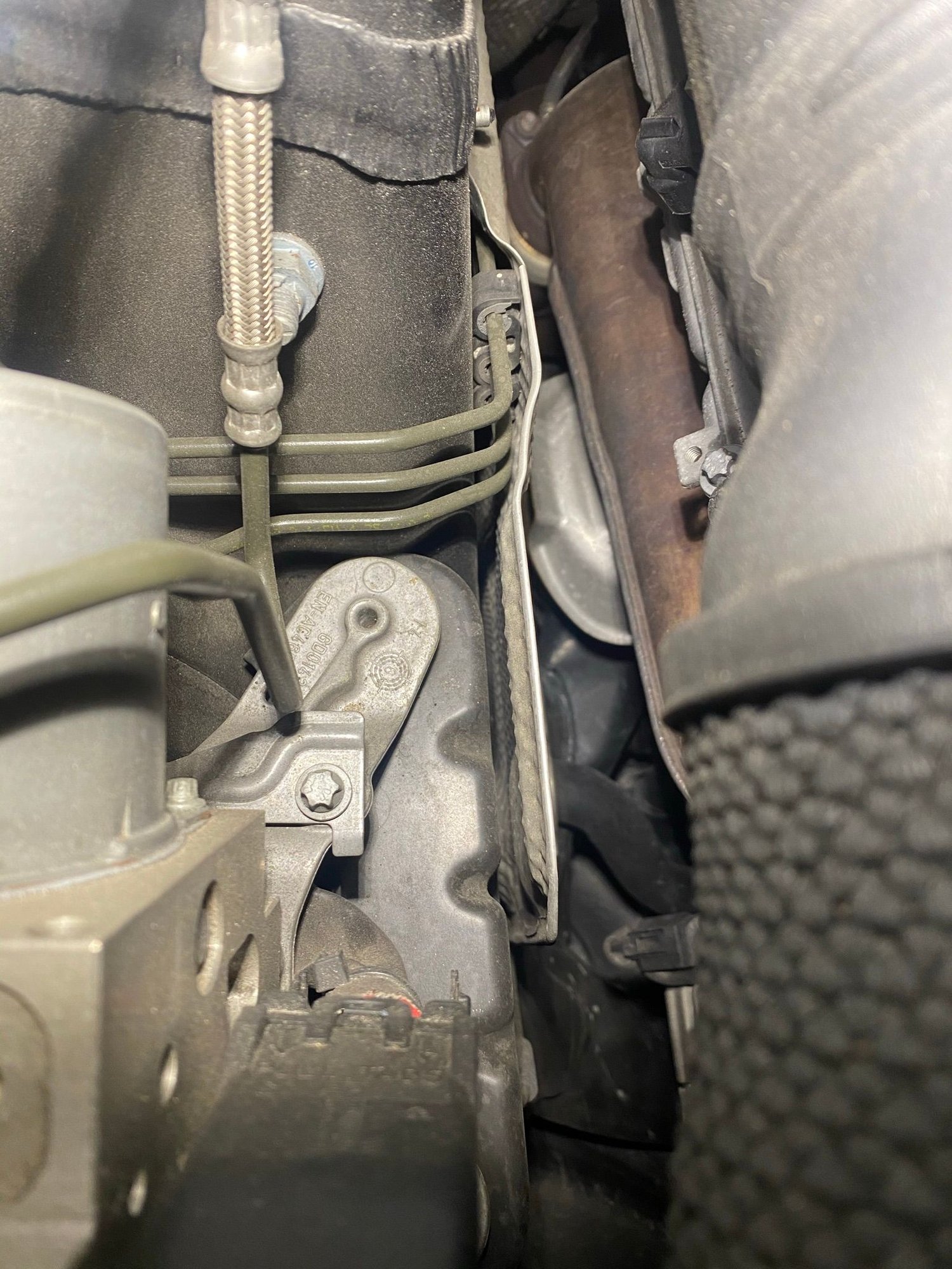

And as promised. Here are a few pics. Your inner fender well liner won't be cut like mine is, obviously. At some point in this cars life someone did this for this very job I'm guessing. I need to get two new ones.
Anyways. Removed nothing from under the car. I did remove the airbox and piping to make room to get to the top mount bolts.

Thanks for sharing those pics. I hope this goes as easily for me as it did for you. Yours is a 4matic as well?

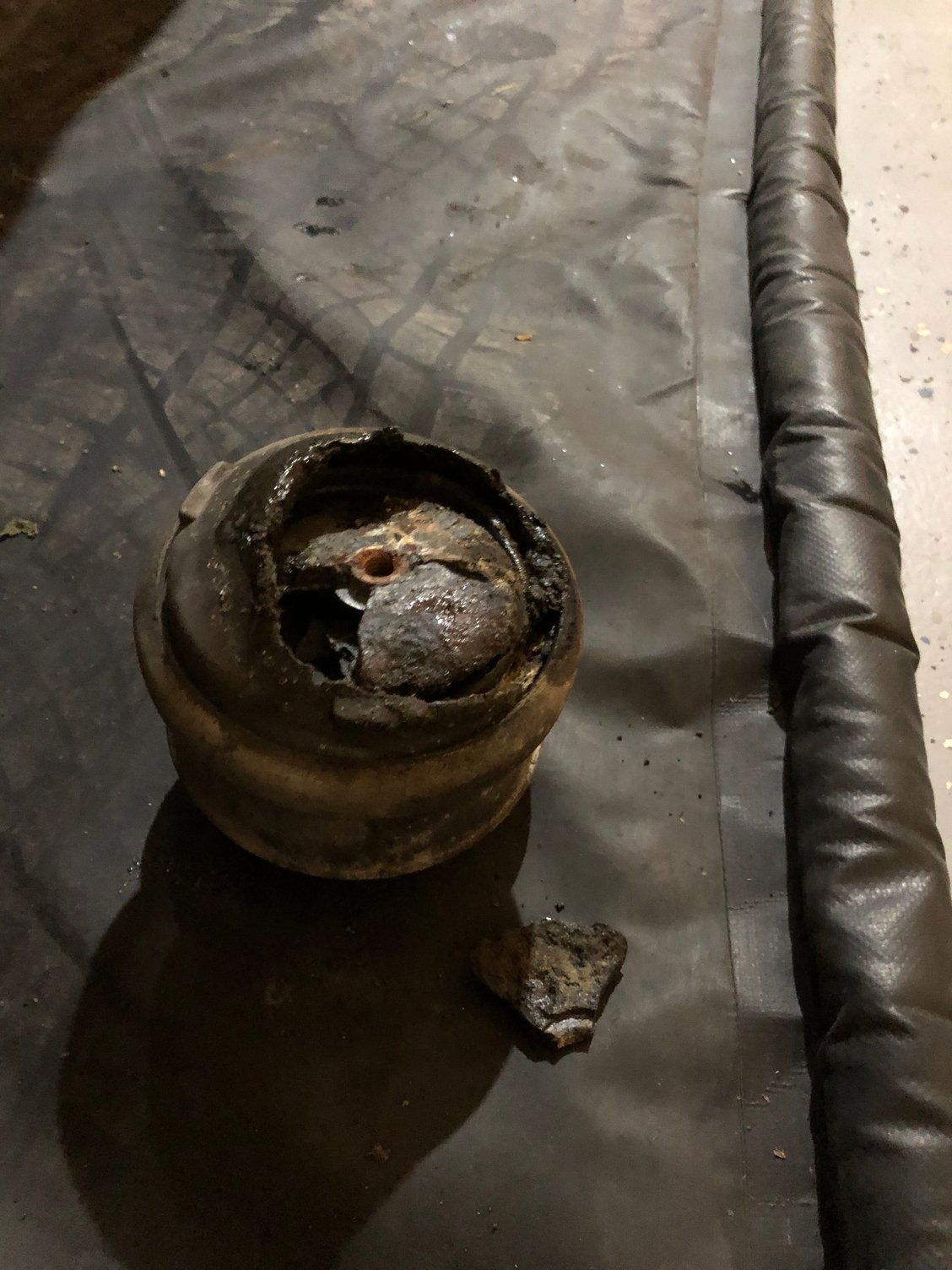

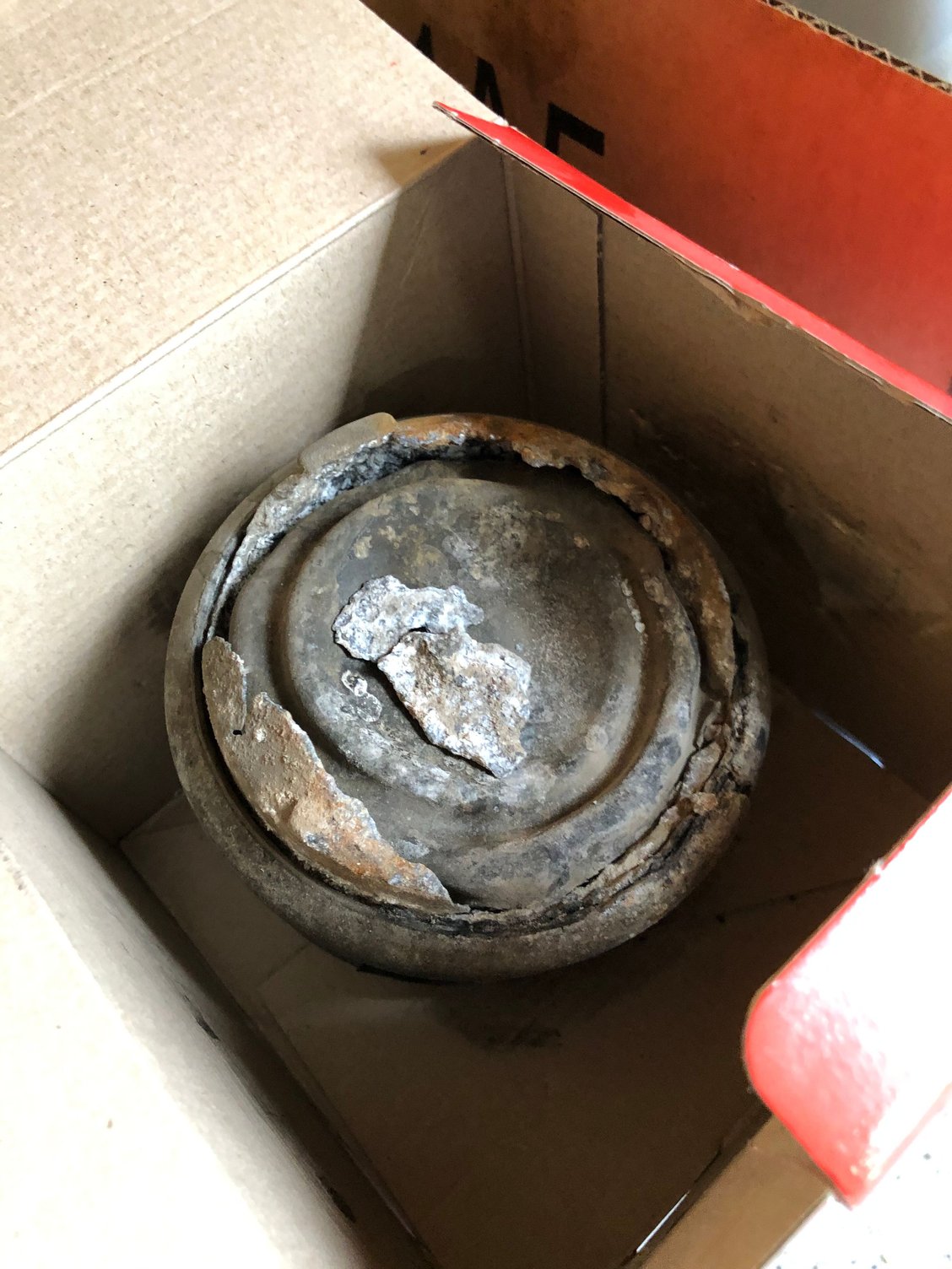

As Rodney said, this couldn’t have been much easier. I did not remove the airbox or induction tubes. I did remove both front wheels, the front most fender liners, and the plastic shield covering the oil pan.
Took about two hours to do both sides and I wasn’t in a hurry. The driver side mount was leaking fluid and rotted. It came out in two pieces. The passenger side had no fluid, and the bottom portion was all just dust.
It’s unclear why I hadn’t noticed any significant issues these last couple years. No idle vibration or harsh shifts or anything.

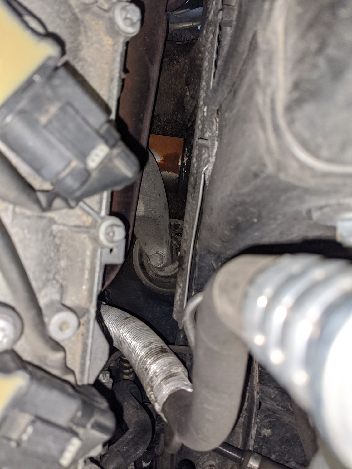

Hey guys
I have a 2009 E550 RWD, and when I looked down from the engine, my engine has this metal shield whereas @rodneypierce doesn't. How'd you remove the shield as I don't see any bolts around it?
Attached:
Passenger Side engine mount.
Driver Side engine mount.

Look at my pictures above. You can see exactly where I placed a chunk of wood to jack the engine up with. It's clear in the pictures.
