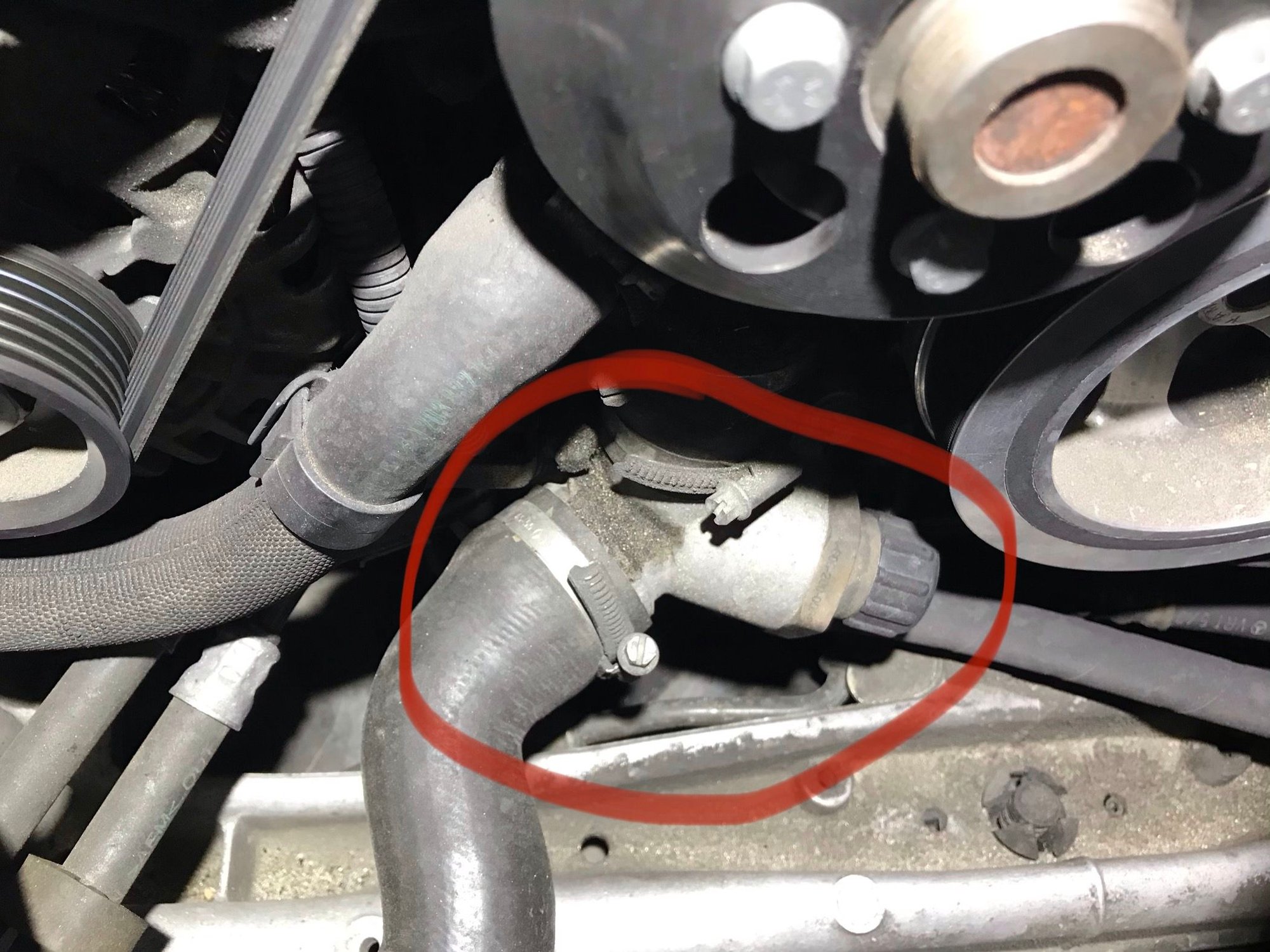

What is this part ?
I have leak coming from the cap and adapter what’s is it call ?

I don't have your vin but this is the best guess. A preheater for the coolant that you plug into the wall. Useful for a car in sub-freezing environment parked outside or where the coolant can get very cold.

It's your block heater. Probably don't need it in Van.
