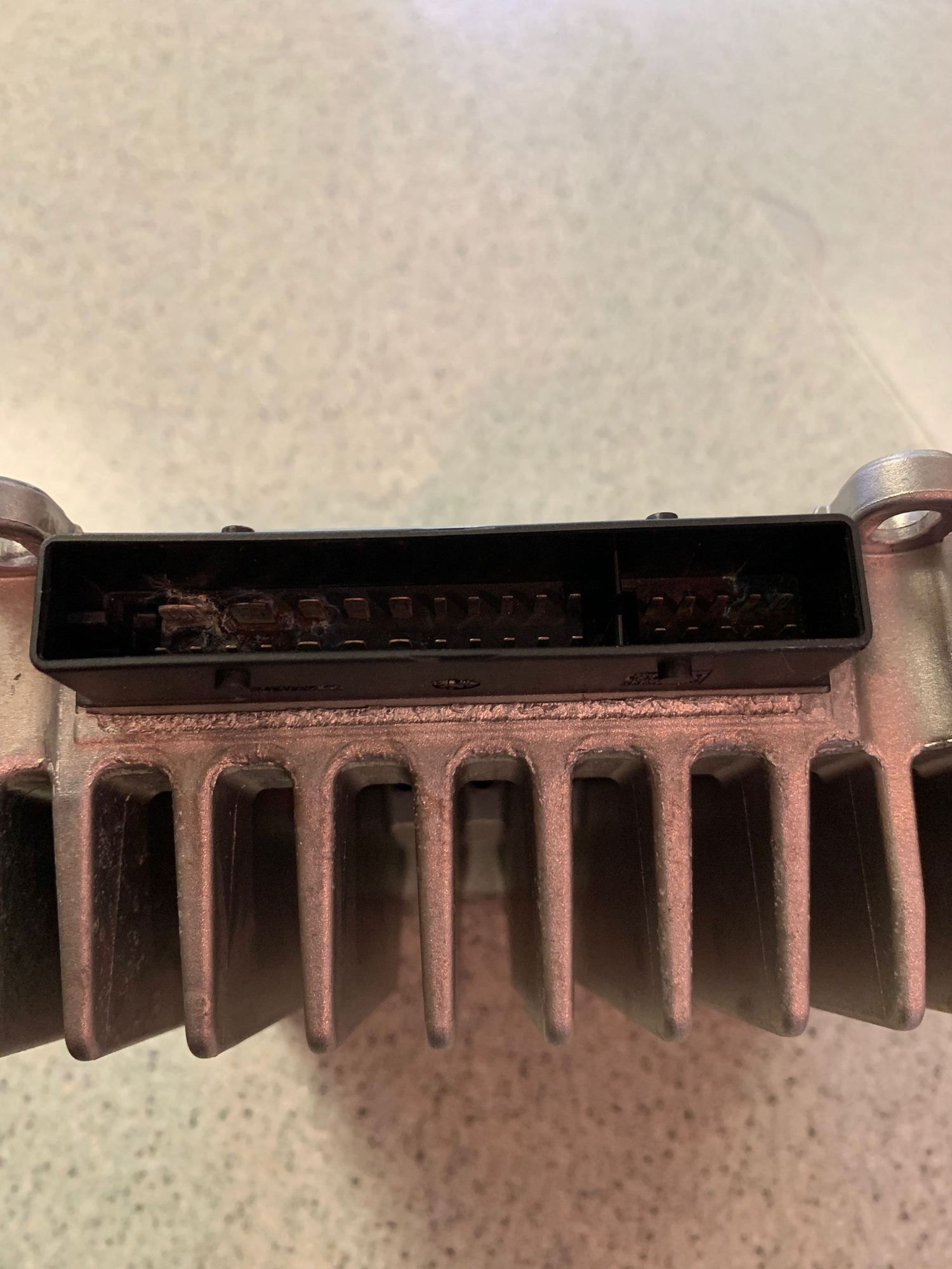

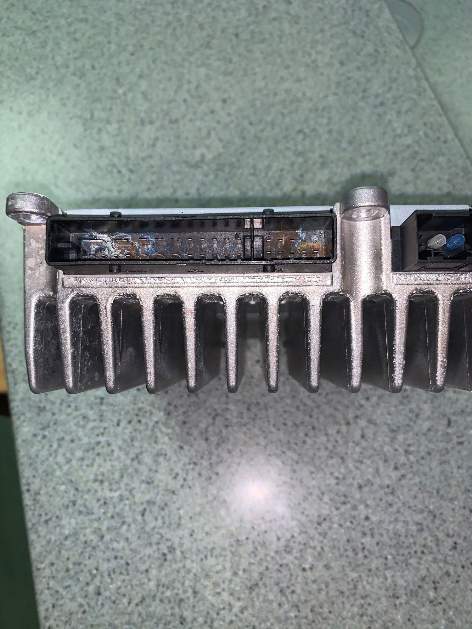

Here are two photos (one with flash and one without) that show the audio gateway connector on the top of the amp with clear corrosion from water. Has anyone had experience with cleaning these contacts and reinstalling the amp for trouble-free operation? Or am I on to finding a used amp?
