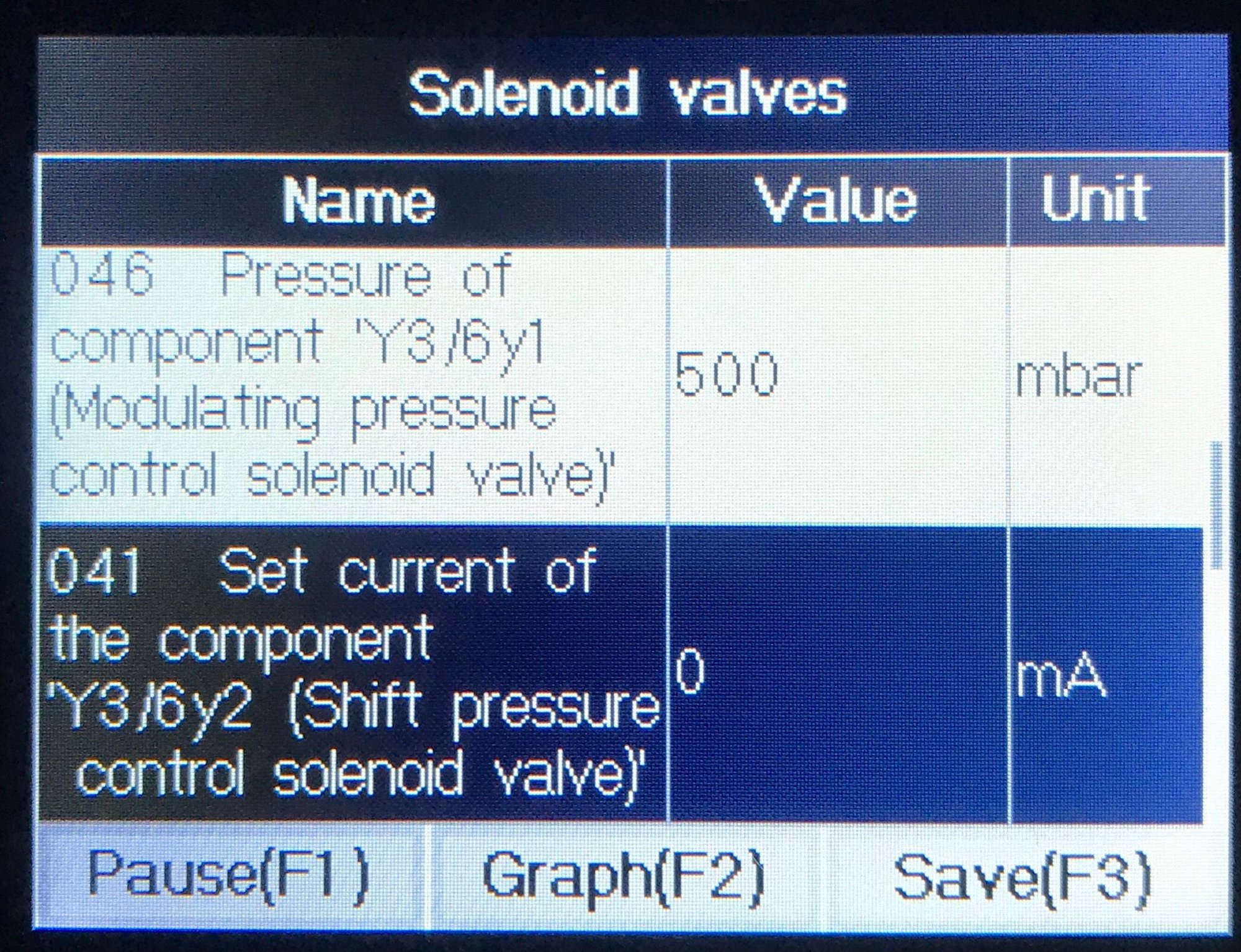

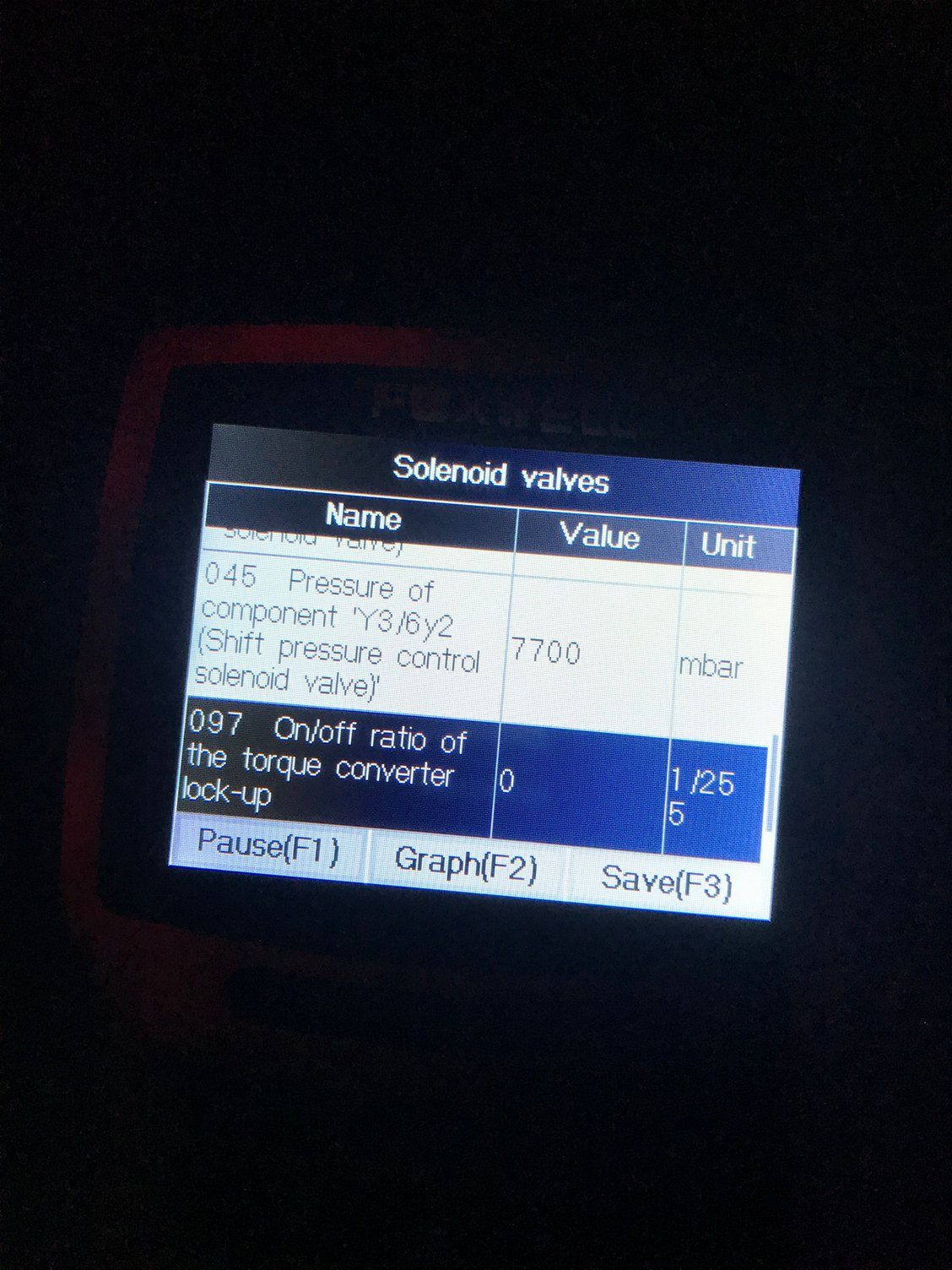

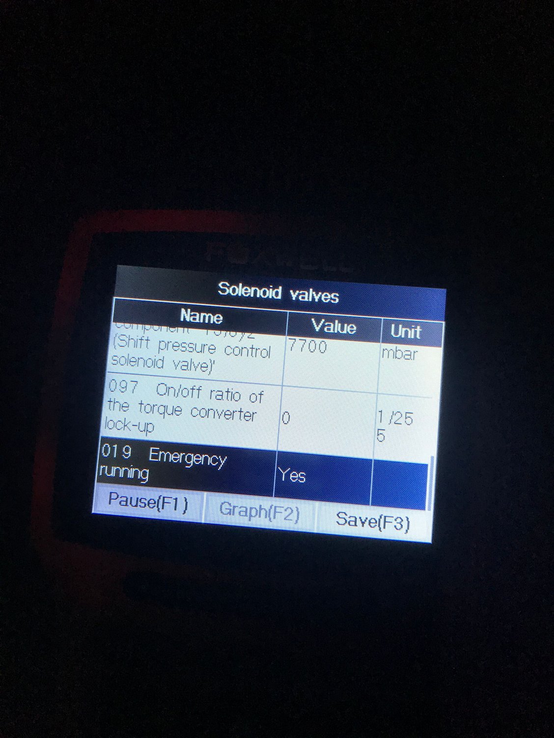

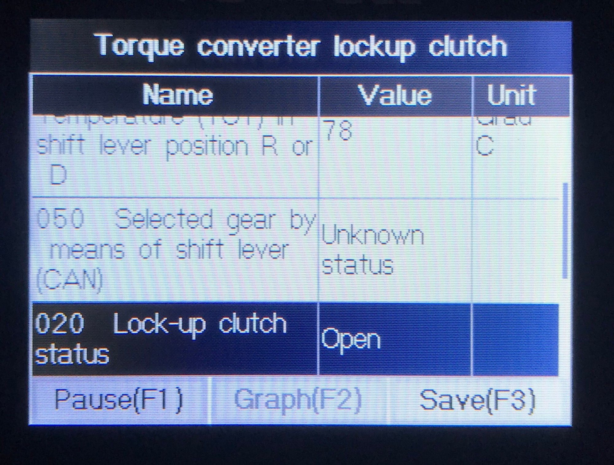

I’m starting to believe that this is a problem with the Central Gateway Module Putting the car in safe mode (limp mode) though it’s clearly super clean, no corrosion. Reason being is that when I try to scan Distronic on Foxwell I get no communication, I try to scan suspension on the scanner and I also get no communication, and no communication Gear Shift Module on CAN BUS. These three are linked to CAN C and N93 Central Gateway Module.
Lost for words... any insight can help. I can provide pictures of codes and or live data if you point me in the right direction.
