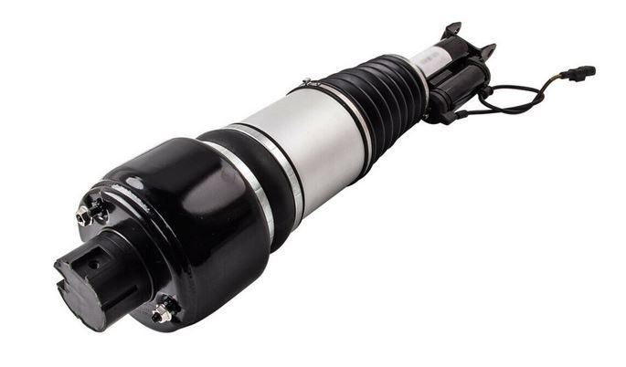

is there anyway to take apart the 4matic airstruts on a 04 wagon?? Feels like i´ve looked everywhere.. Alternatively is there any way to get the rwd airstruts on the 4matic car? thanks

4matic front left 2113209513, right 2113209613; RWD 2113206113, 2113206213.

04 e320 wagon 4matic & RWD are same OEM part # 2113200925.
That's not a strut, that's a rear air spring. Air struts are on the front and and they are different on airmatic vs rwd. 4 wheel airmatic was standard in E500 4matic wagons and E55 wagons, optional on E320 and E350 wagons, with or without 4matic. Rear only self leveling was standard on V6 wagons. Airmatic rear springs are NOT the same as rear self leveling air springs.

Correct, revised post.
