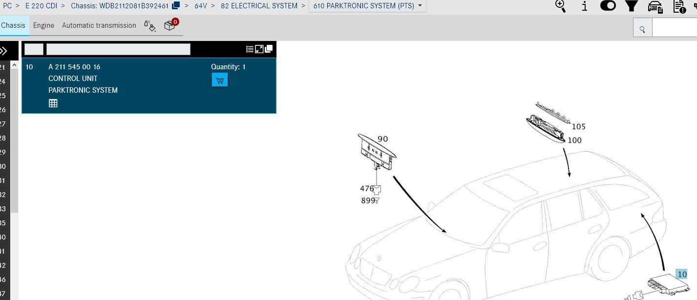

The instrument cluster has a message on the rear licence plate light (bulbs are just fine), the radio is not well heard and the boot curtain does not raise electricity. I suspect a fault in the rear sam unit. The unit code is A 211 545 00 16 and the Vin number of the car is
WDB2112081B392461. Is this just the exact same numbered Sam unit?

2115450016 = Parktronic CU if in fact SAM is bad here are compatible part #s.

Thanks, i order "cheked" part by same number. We´ll see what happends
