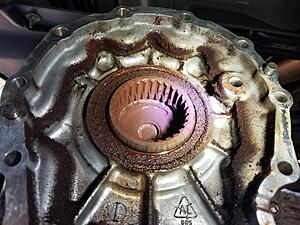

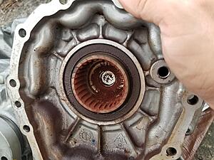

At 70k miles I had the coupler/flange between the trans and transfer case chew up the splines. Long story, but dealer didn't replace (when car was under warranty) the output shaft bearing that was failing, so I figured that was to blame for the failure.

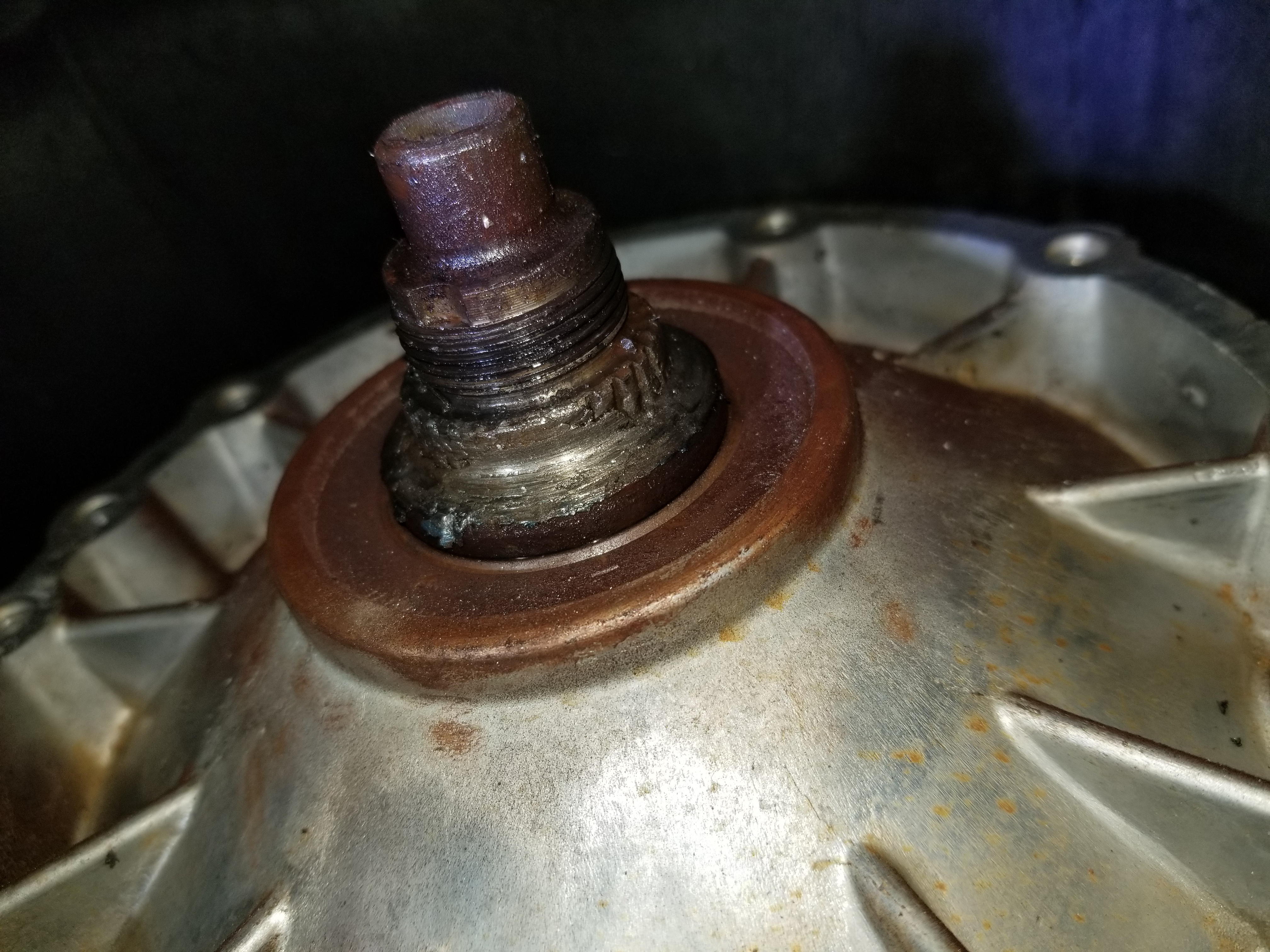

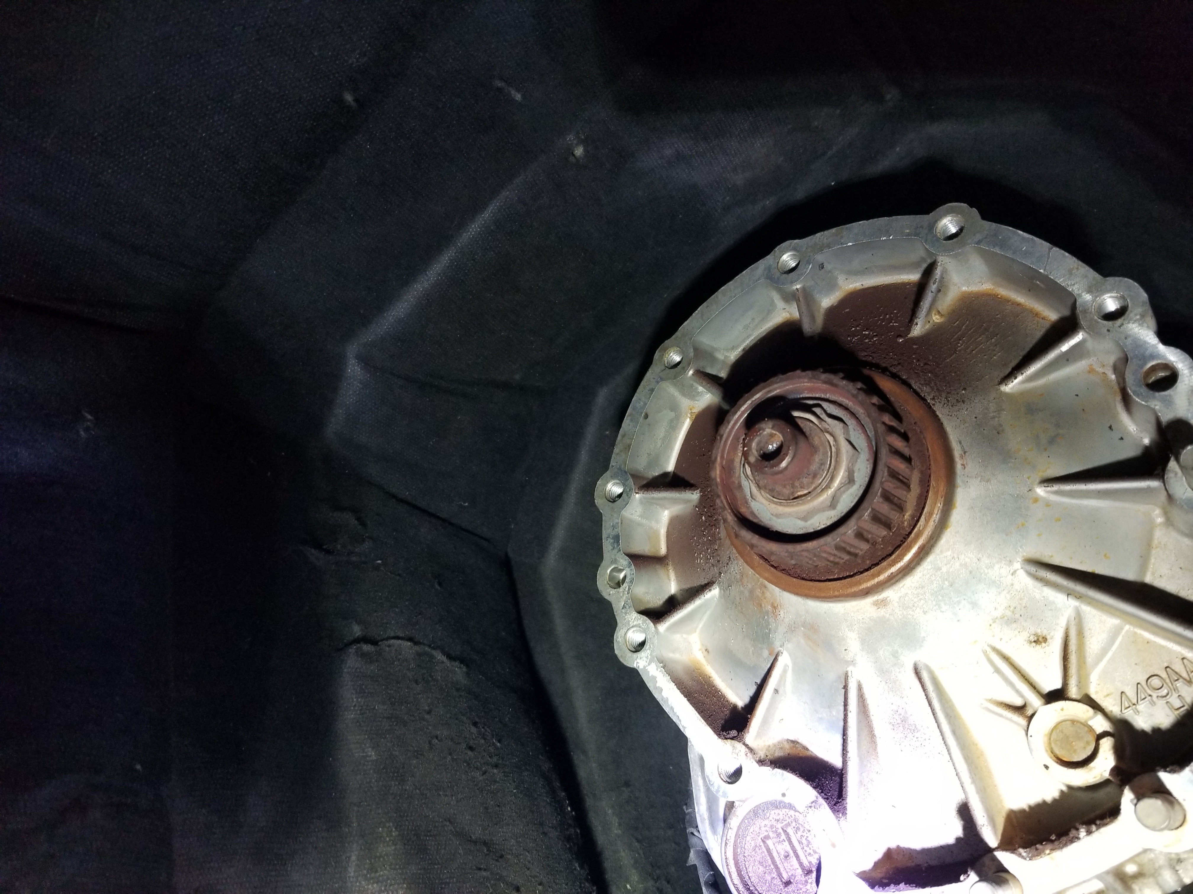

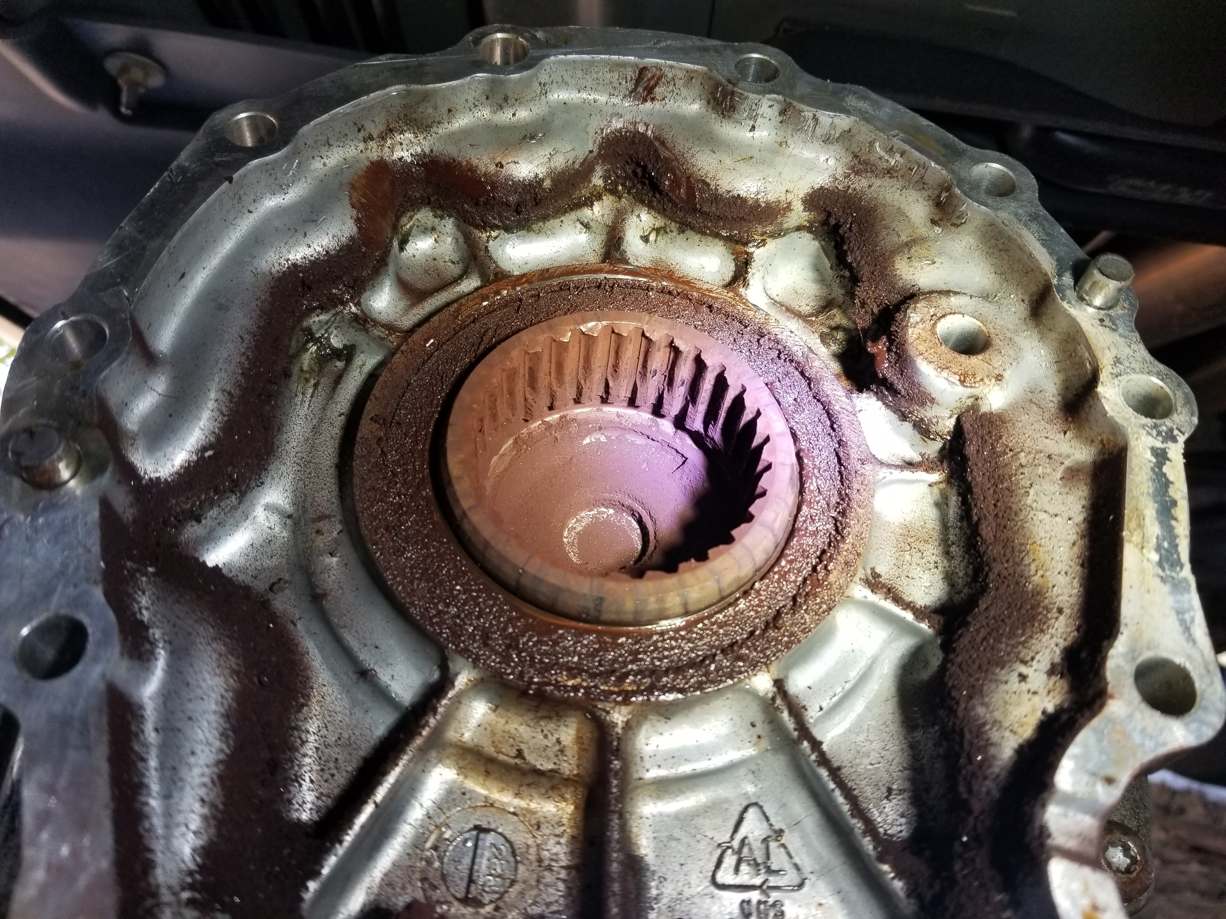

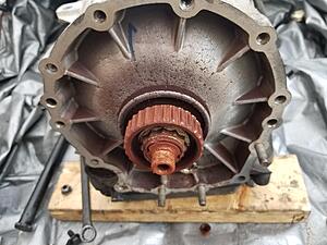

I wound up getting a trans and transfer case from a wrecking yard with 4k miles on it (from a v8 chrysler 300). I put that in 6k miles ago last summer, so this trans and transfer case has about 10k miles now. This week taking off from a stop I got a violent shake/grind. The car would move normally under very light throttle, but completely gave out trying to go up my steep driveway (was only a mile or two from home). This time not only were those splines chewed up, but the coupler sheared off and has damaged some of the splines on the trans' output shaft.
