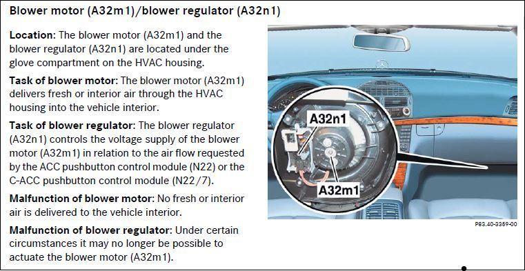

Best to have someone pull fault codes but if A/C operating unit is powered (f64 @ front SAM in engine compartment) and problem is isolated to air flow check blower motor/regulator (no fuse). Replacement parts: regulator shop used 2308210251, 2308216351, or current used/new 2308216451; motor used 2118300408, or current used/new 2118300908.
File Type: pdf
Thank you so much!
thank you so much i will get this solved immediately and reply my results.
