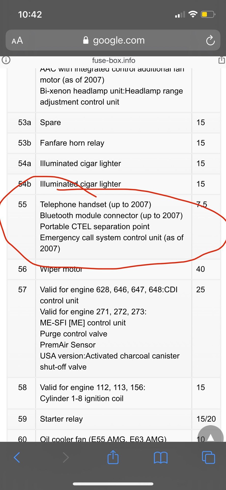

Hey Folks, for the past 2 weeks the car has been constantly draining battery when the car is off. I bought a new battery / new aux battery / went through the shop as well. It seems that these two fuses (attached picture with arrows pointing) are the ones that are draining the battery. Does anyone know how I can fix this issue or if someone can locate me to relay or module that these are connected to? Any help would be appreciated! Thanks.
These two fuses are the ones draining the power
Diagram
Circled is the fuse description
Circled is the other fuse description

The arrow on the left side is pointing to the reddish 2nd fuse 7.5

Is there a relay that connects to those fuses? If so, you might want to check those also. I do recall reading about telephone sos having issues. You may want to search for that online.
