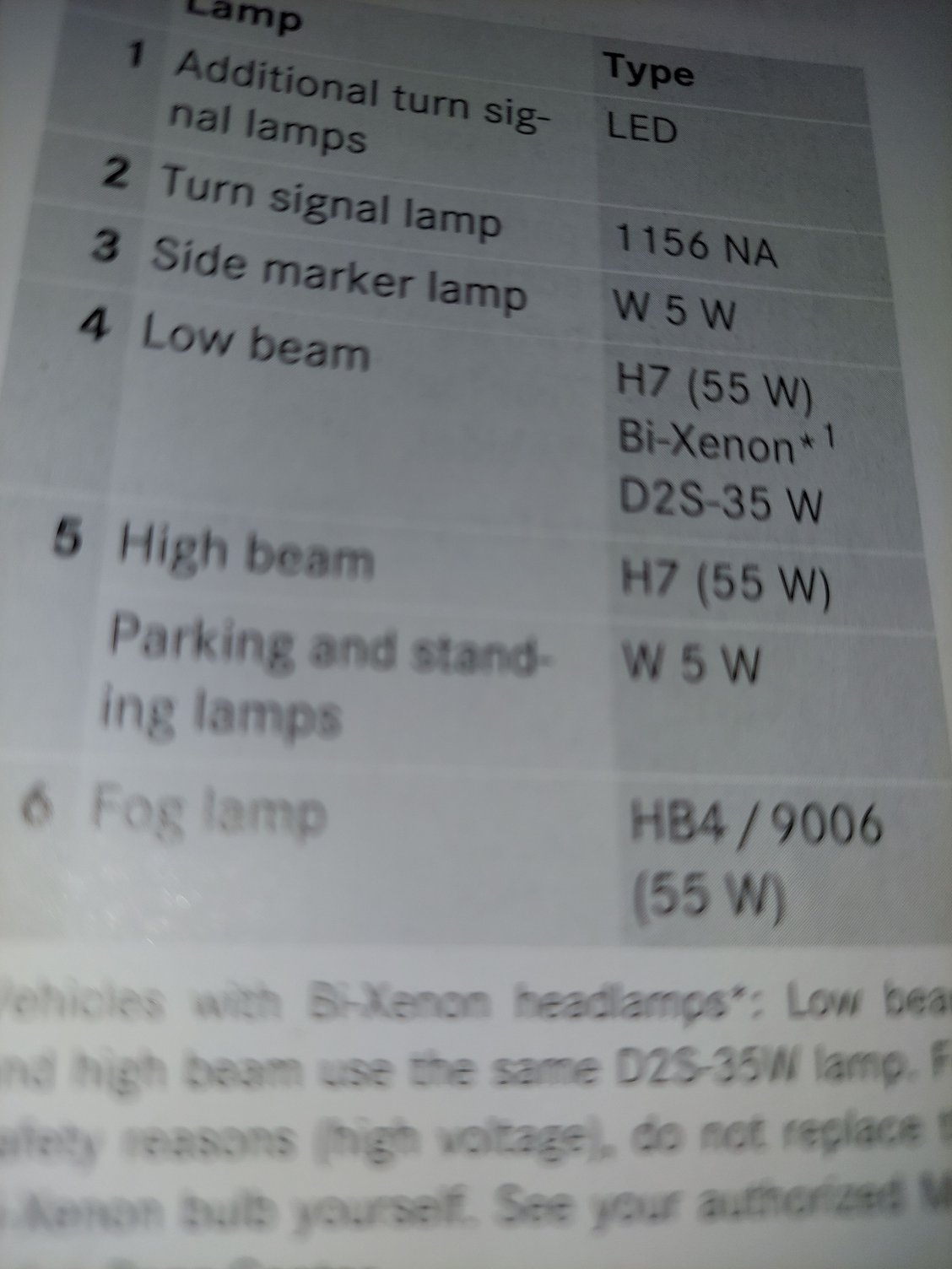

Originally Posted by Plutoe
its all spelled out in your manual--get off the couch and look, bla bla
Yeah,well guess what ? The manual says 9006.​​
I pulled the bulb to be sure and they're H11's bla bla
People couldn't even agree on how to access them on the web. I read there's a door you give a quarter turn to and you have to remove 8 bolts from the undercarriage splash guard..
it's why I asked the bulb question.
All I needed to do was remove one plastic rivet and one bolt in the wheel well.
But thanks for your insightful post.
