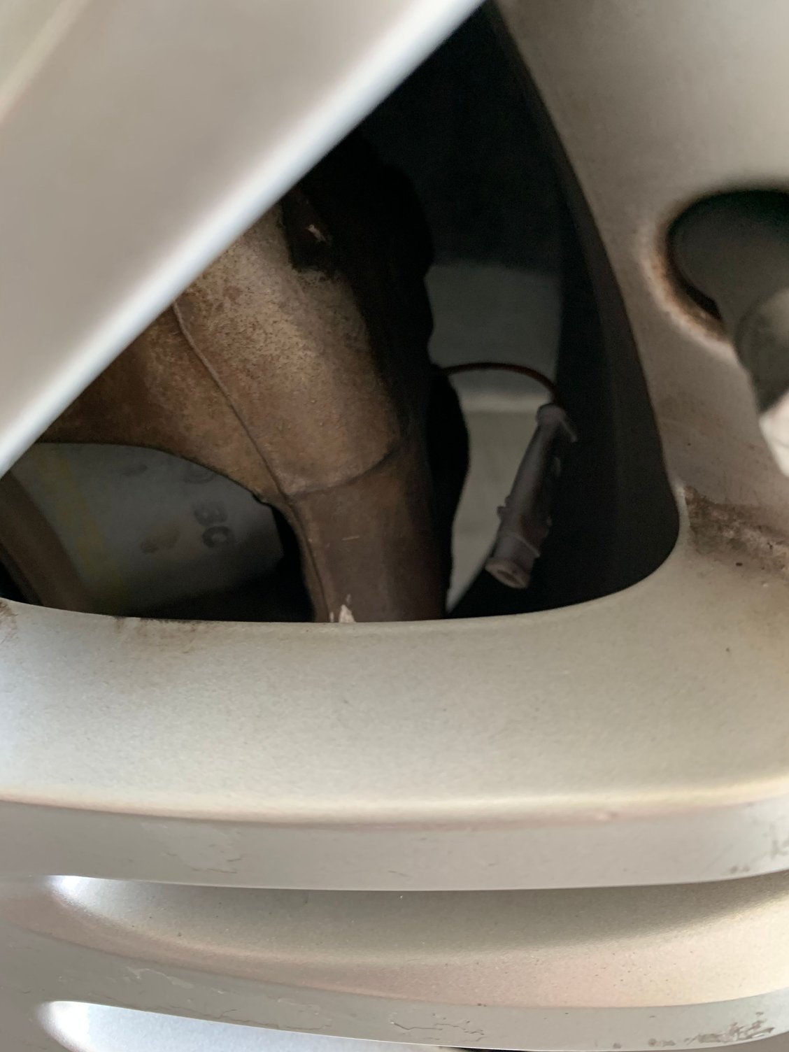

As the title states, I have a 2006 e320 cdi. Brake pads and rotors were replaced in the front. The light turned off for about a week after the new parts were installed but then the brake wear visit shop came on. On the passenger side the wire from the brake pad is intact but on the driver side the wire is just hanging not sure if it came loose.

03-05 equipped with 2 front sensors left 50% wear, right 100% and rear right 100% MBUSA eliminated front left 50% sensor from series production for 06 If you cut the wiring or leave it unconnected you should connect both wires to close the circuit this should eliminate warning message. Also see attached bulletin.
